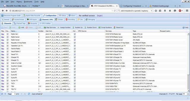

Anyway after poking around, my web screen looked like this:
CHANNELS! Somewhere there is a map button, this takes all found stations and maps them to Openelec TV Channels. See the play links along the left side? You can stream channels from here too.

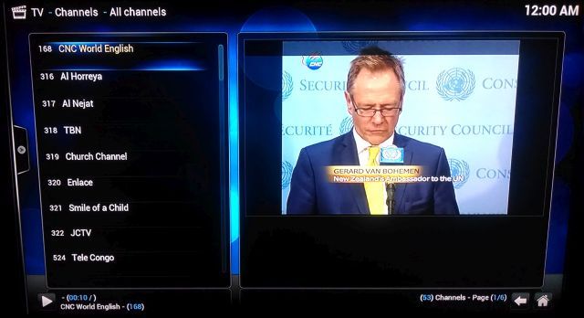

Now Click on TV. Click on one of the channels and it should give you a preview like this:

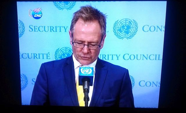

Double click and the channel will appear full screen:
Not quite full screen. On the Pi there a many options in config.txt to fiddle with including options to fill the screen properly and remove all the borders.

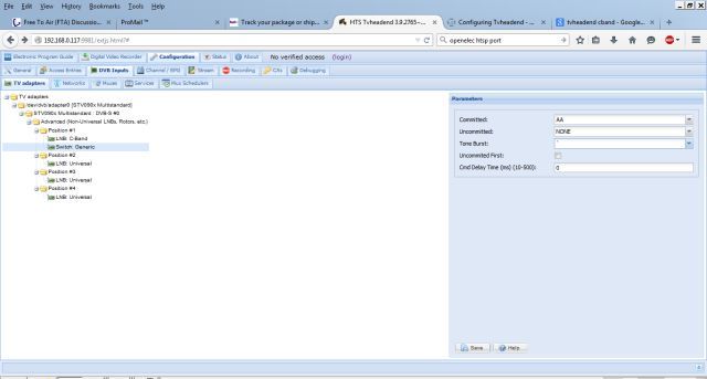

Under The Tv adapter Tree, select the adapter, then Satconfig setting is set to advanced.
Click on Advanced in the tree and set orbital positions to 4.
Then at each position you can set Diseqc and tone!
Reactions: KE4EST
So far committed diseqc works as advertised. I have 101W on diseqc Port 1 22hkz off and 105W diseqc port 2 22khz off working.
Now I am trying to get 97w working which is diseqc 1 22khz on, since its on my first multiswitch. Struggling so far with 22Khz.
