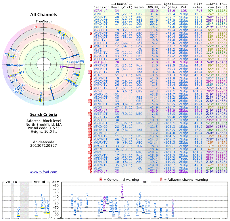

I've read chimney mounts should be done on a 10' mast is this correct? I'd consider either method, although I could use some suggestions on how I would mount it in your second suggestion, because I don't believe the ones I posted a snapshot of (which I have) would do it in that case, unless I mounted against the anterior wall in that corner, rather than against the smaller wall facing the side street (that the plant is hanging on). The cheaper the better. I did start to grow fond of the idea of having it in the back of the house to be out of sight (the antenna AND the ground wire/coax). Also, since I did purchase 100' of ground wire, I don't mind running it, unless it doesn't work as effectively if it's such a long run. If the trees are an issue that's another matter. Here's my tvfool POST transition followed by current, by the way.

The tvfool graphs don't help me much because I'm not sure of the orientation of the house and I'm not sure which stations you are trying to get out of that big list.
