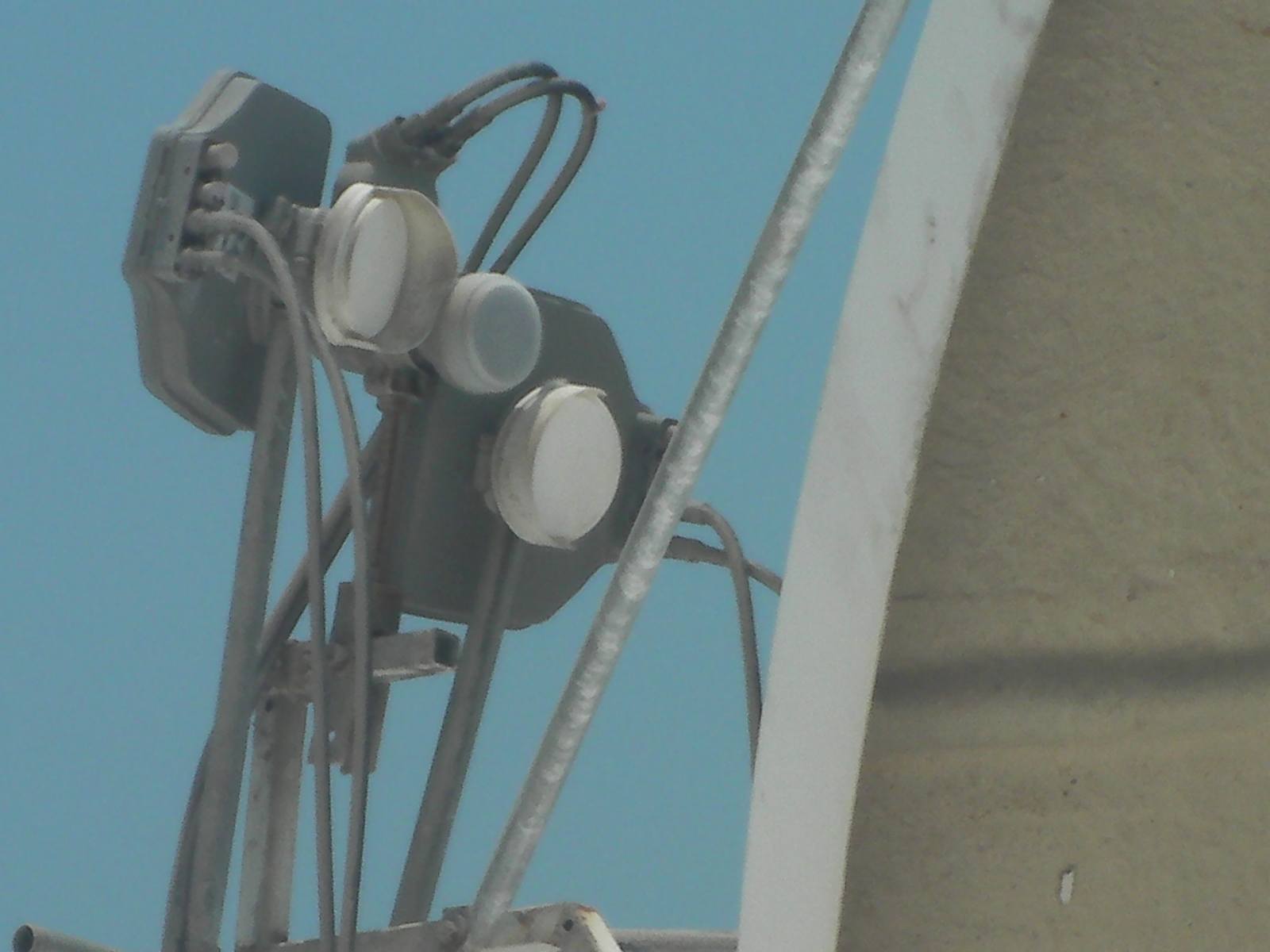

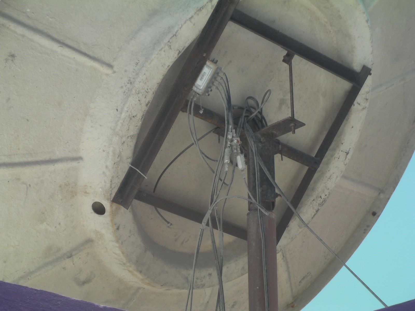

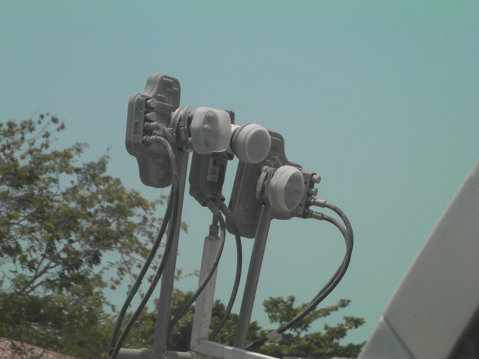

Here is the Directv setup I would like to accomplish.
This is for a 8 foot dish for 99W, 101W and 103W way South of the border. This is a non SWiM set up.
I will be using non-SWM lnbs and an HR22 dual receiver.
Who can help me especially with the switches ? (this is a set up for 2 receivers or one dual receiver, so I guess)
Will I be needing a Directv AIM meter for tuning or will the receiver show me the signal for Ka?
This is my first time ever setup on Directv.
Thanks !
