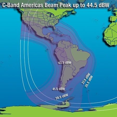

I can see IS-14 here in Halifax with my 10.5 on my spectrum analyzer but nothing strong enough that I could get a lock last time the dish was over that way. And looking the C-Band foot print I'd think I was a long way away from decent signal, but I was about 3db or so away from locking something.
