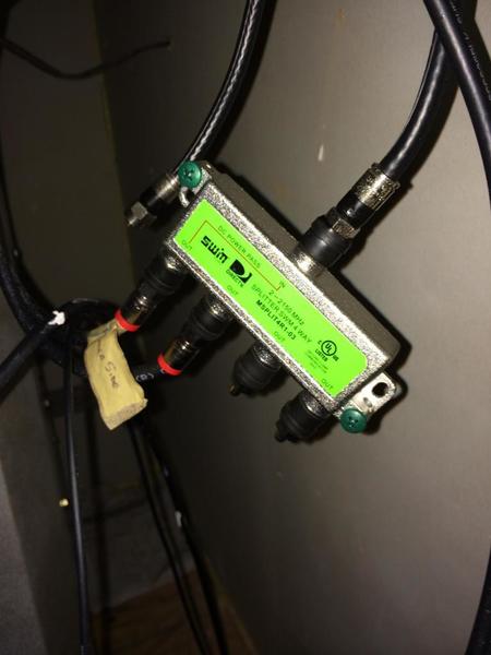

I understand id have a unified playlist, but would have to manage timers separately. I figure Id rather have the second DVR (used to have two Hoppers) to run as a backup for recordings, because even in the slow times we tend to run 2-3 weeks behind.
Here is the closet connection, just wondering if anything needs to be done differently to connect the HR24 where the Client was, or it it is plug and play?
Thanks.
Closest connection? Do you have more than 1 SWM splitter? Are you just running an HR44 and HR24?
"Closet" connection. That is all I have right. Coax from dish drops in this closet and all house wires drop in here. What you see in the pic is the in from the dish, one out to genie and other out to where the client was. Can I just hook the HR24 right up how the client was connected?
Yes,
Provided that the Power Inserter is also on the run.
The PI needs to go on the run that has the red line going to it, the farthest to the left.
I guess I dont understand, with the Genie there is already a PI on the run.
The setup is simple, one out goes to the Genie/PI, the other went straight to the Client.
I was just verifying the PI, seeing you didn't mention it.
So the Genie is on the farthest one to the left with the PI, the other one connected is the run to the old Client ?
If so, Yes, just connect the new recvr to that line and boot it up.
Thats exactly right, the Genie and PI are on the far left one with the red line, the client line to the bedroom is the one next to it.
Im gonna order a HR24 tonight and I already have a few 1 and 2 TB HDD's laying around, will get an EHD ready. Will make for a nice backed up system.
The hard drives you have are esata, yes? Those the only ones that will work with Directv dvrs.
Oh yeah, two types of thermaltake cases and 3 drives. I think I have 2 2Tb drives and 1 1TB drive.
Im just gonna put it in the bedroom and let it go. I figure one DVR crashes, got all or most of my other junk on the other.

Got it installed, booted, activated, rebooted for new software, then shut down and hooked up EHD. Powered back up and all is well. 2TB's of back up space for the Genie :)
