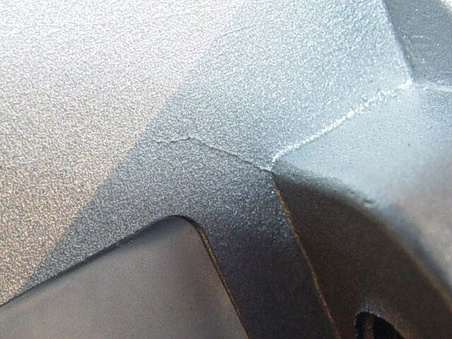

It is VERY important when installing the SG-2100 motor to FIRST tighten the square U-bolts and bracket to the pole BEFORE tightening the motor to the bracket. If you don't, it can cause hairline stress fractures to the motor casing. Please see attached pic...
Don't know what I'm going to have to do here, I'm pretty sure moisture could enter the motor casing through these fractures and ruin my motor prematurely. Does anyone have any ideas? I might have to buy a new motor :(
I feel SO stupid....
And the best part is, I'm tracking the arc PERFECTLY! Oh well, if I got it set right once, I can do it again...
Tron
Resident Idiot
EDIT: The fracture is just above and to the right of the DMSI sticker, about center of the picture. It radiates from the part of the motor where the bolt is secured...

Either that or Epoxy *MIGHT* work, but then you've gotta figure the motor casing has been weakened and the fracture could get worse with stress from operation, wind load, etc...

you know what.. I just checked my motor that I recieved today (thanks again PSB!).. I have the exact same mark, and I havent even done anything with it (its still sitting in the box)...
it looks like you have nothing to worry about, its just a casting mark.

EDIT: Ultatryon, didn't see your last edit... Thanks! That makes me feel better... Does anyone else notice this mark? There's another on the other side of the motor, but not as long or visible... Pictures?
Try drilling a small hole in ech end of the crack, it might prevent i from cracking anymore. Then seal it up.

yea, I see one on the other side as well, not as long.. like 1/16" of an inch, versus the 1/4" on the other side.
This is definately not a fracture, just a casting mark.
*WHEW*! Thanks Ultatryon! This is a major relief. I've been down all day because I thought I'd ruined my new motor.

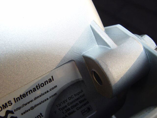

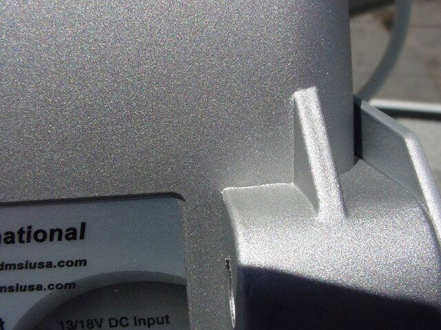

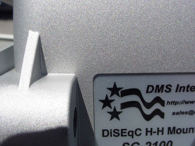

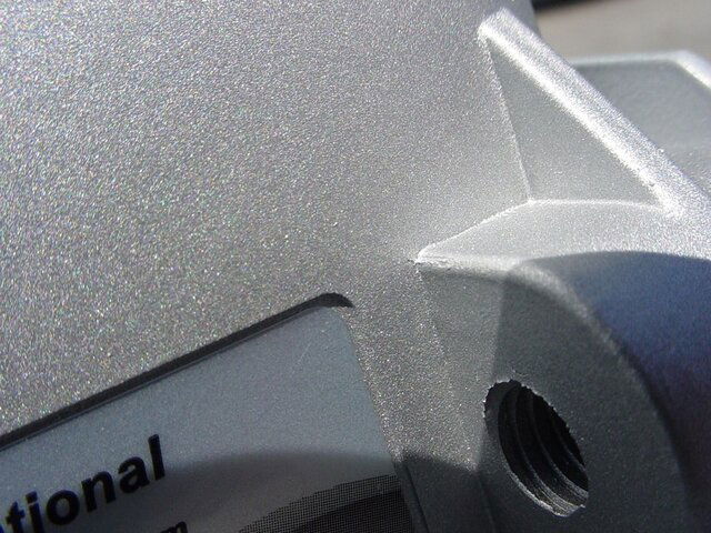

Can you get a pic of the marks, just to fully put my mind to ease? :D
Thanks! :bow
Tron
I will tomorrow, I forgot to bring my camera home with me tonight... and the motor is going up tomorrow morning, so tomorrow night I will snap some images of it (of course after mounting)
I just went up to put my new Invacom .3dB lnb on (yes, in the dark, at 12am, lol) and spotted the exact markings on my SG2100. I tried getting some camera shots, but my camera just laughed at me and they all came out blurry :rolleyes:
Just wanted to let you know you did nothing wrong; the SG2100 is a pretty well-made strong-cased motor, and the lines you see apparently come "standard" with many of them :D
