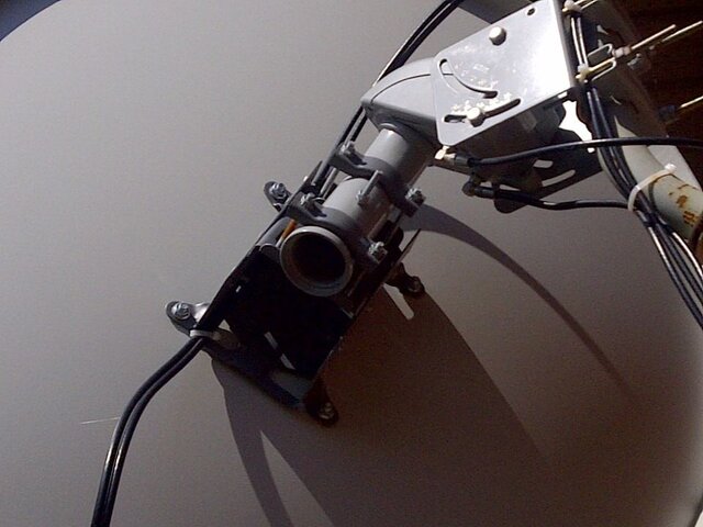

what i did was drill a hole through the motor tube and through the dish bracket then installed a bolt that goes through the shaft and dish bracket....this bolt serves two purposes....it keep the dish from turning an the shaft and it prevents the dish from sliding down the shaft like you said....this one bolt basically holds the dish on the shaft but i still installed the u brackets anyway....i will see if i can find a picture for you.....i know i have one somewhere....i would still get the larger shaft though....
it is hard to see in these pics but the bolt is between the two u-brackets.....i installed this bolt to prevent the dish from rotating on the shaft....it goes through the shaft and through the dish mounting bracket on the side closest to the dish....
i have installed another bolt that is similar to this one that goes through the mounting post and through the motors mounting bracket....this bolt prevents the motor from turning on the mounting post in heavy winds....this bolt is between the motors two u-brackets....this one is very hard to see in the pics....

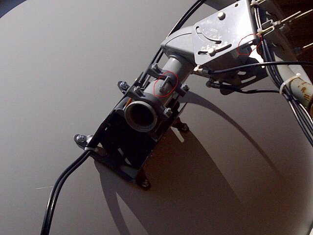

i have circled the bolts for better viewing

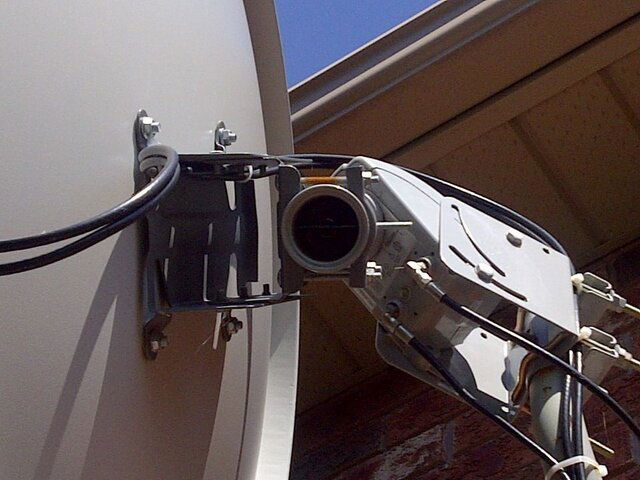

The mount that you have posted a picture of was not designed for a ku HH motor. Mounts that were made for ku motors will have a slot cut in them to accommodate the lip that is at the bottom of the motor tube. This lip keeps the dish from sliding on the motor tube and it makes drilling the hole through the motor tube unnecessary.
Attached is a picture of a Geosat 1.2 meter dish mounted to a hh motor. The slot for the motor tube lip is just above the dish elevation rod. GregH
any dish can be used on a motor.....
the SG9120 that i have in the pics has a "lip" on the motor tube at the bottom....this "lip" will prevent the dish from sliding down the motors shaft....that is not the reason i drilled the hole....the reason i drilled the hole and installed the bolt was to prevent the dish from turning/rotating on the shaft....
The dish will not turn or rotate on the shaft if the lip of the motor tube is installed in a dish bracket that was designed for a motor.
Mikey11 said:
yes it can still rotate
You are correct to state that a u-bolt design mast clamp could spin on the motor tube in extreme wind. If the wind was that strong to spin two torqued u-bolts, I would prefer that the dish might instead slip on the tube than to damage or jam the nylon gear of the SG2100. Newer motors with the metal gears don't experience this type of damage or failures.
Well I am the type of person who likes to "over-do" things, when I install a dish/motor assembly it will be there for life and will never need adjusting again, wind, rain, snow, hail, sleet, I don't care, it aint moving after I am done with it,
Some of my installs the motor/dish are located in places that are basically not accessible for 4 months of the year because of snow, so I need to make sure it is bullet-proof,
5+ years of installing....number of calls to re-adjust/re-aim a motor/dish....zero
A couple of years ago, I read a post made by a guy who liked to over-do things. He put a commercial dish on a StabHH120 motor and mounted it on the roof by the chimney. It was the only place available where the dish could see through the trees. Everything was fine until he accidentally disabled the East/West limits on his receiver. When he did this, the dish ended up hitting the chimney and breaking the steel gear inside the motor. This is the only time I have heard of a steel gear being broken and I doubt this would have happened if the dish had not been bolted to the motor shaft.
