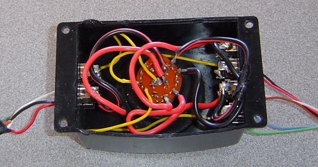

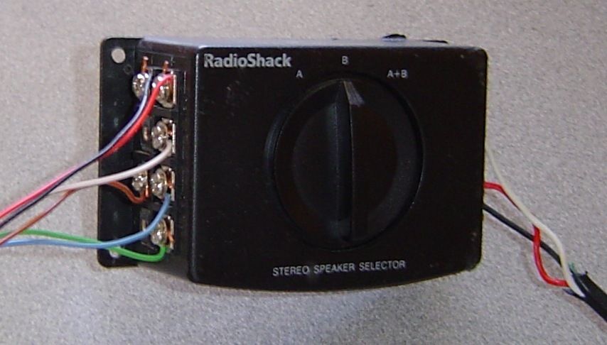

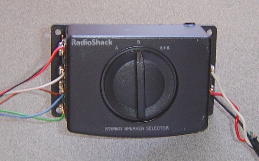

Anole asked me to take some pictures of the little polarity splitter I made a long time ago, so here it is. :)
Are you tying the 920 and DVB grounds and switching the power and servo leads?
I really don't remember exactly how I did it, but I think you are correct. A shared ground.
I would have to get the switch on the bench and run the lines with the multi-meter again to be sure.
