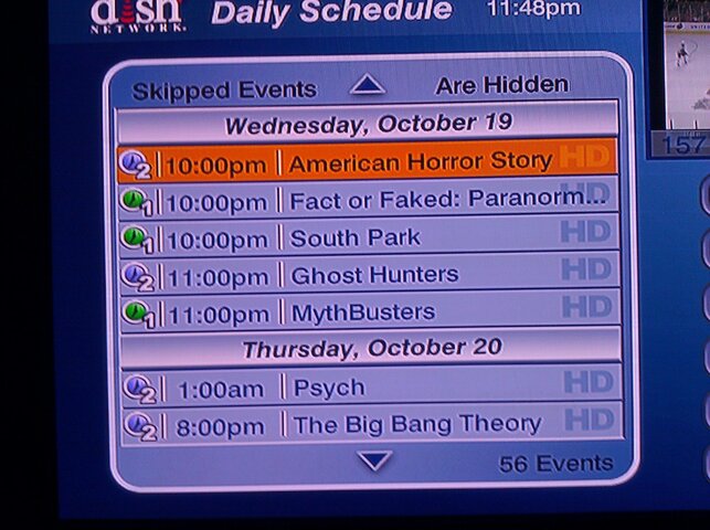

This happens every once in awhile, but the past week or so it has happened a lot. For example right now my local Fox (WNAC) is recordingFamily Guy, but the show data is episode 37 with an original air date of 8-29-01. And American Chopper: Senior vs. Junior with guide data of episode 29 and original air date of 9-19-11. All my timers with this problem are set for new shows.
In the past week (I deleted the shows and can not give guide info) Ghost Hunters, MythBusters, Burn Notice, Sanctuary and a few others I can not recall that had full guide data (episode# and original air date) were recorded.
For future timers I see MythBusters set to record for 10-16 (ep302 oad 10-15-11) This ep has already recorded twice. Ghost Adventurers set to record 10-17 (ep4 oad 10-31-08), Louie set to record 10-17 (ep15 oar 9-7-10), Destination Truth set to record 10-17 (ep42 oar 10-28-10) and three other for the same day, Doctor Who set to record on 10-17 (ep 83 oad 6-5-10), America Pickers set to record 10-17 (ep24 oad 10-4-10).
I can go on with more, but I think this is a good sample.
This in on my 612 with L642.
Anyone else have this problem?? And if this a know issue that I could not find please let me know and delete/merge my post.

This might also be related to my issue. I have had this problem for a long time with my 612 and also my replacements. I know a few others have had the same issue. As you can see from the image some timers try to record on tuner one at the same time. Dealing with this for a long time I have found out if I add a timer and there is a conflict everything is ok for the week when the timer was added. But, weeks after if there is a conflict the timers try to record on the same timer.
