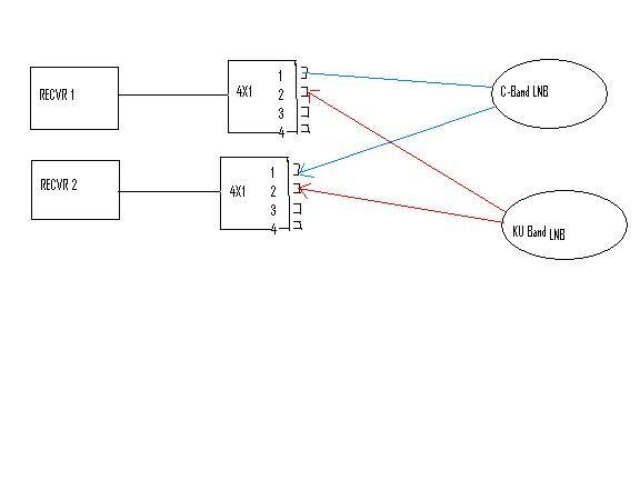

I have a very perplexing problem with my latest C-band and KU setup. Here is how I have my setup. I have a C-Band Mini-Bud (Dual Output) pointed at 99.0°W and connected to Port #3 on 4X1 diseqC (there are two 4X1 DiseqC switches, each connected to a receiver) switch and a KU band Dish (Dual Output) looking at 30.0°W connected to Port #1. Here is the problem, if I'm watching different channels from same satellite on separate receivers there are no issues, but when I have receiver #1(Bedroom) on any C-Band (99.0°W) channels, and then choose a channel on receiver #2(living room) on Transponder 12092 V, 27500SR for example, receiver #2's Quality drops practically to "0". I have swapped the receivers and the same the signal loss keeps happening to any receiver placed in the living room. The C-Band LNB is a "Dual output C-band LNBF GEOSATpro C2", the KU, is an "Eagle Aspen 270 KU" LNB, and the switch is "Chieta" 4X1 DiseqC switch. Any one have any ideas as to why this is happening?

Now, I'm really stumped! I just got a new pair of DiseqC 4X1 switch from Sadoun, and the issues still persist. When, I connect the connectors from the C-band to Port 1 and connect the connectors of the KU Band to Port 2 s of the 4X1 DiseqC, (Receiver 1 on C-Band and Receiver 2 on KU Band) all quality signal drop to absolute ZERO when the second receiver on a KU band Channel is turned on and vice. But, When I swap the connectors to C-Band Port 2, and KU Band Port 4 on the DiseqC switches, everything works fine. Remember, it also worked the same way, even with the old Chieta 4X1 switches that I had before. I have changed all F-connector ends on my cable and swapped out KU LNBs, except for the C-band LNB, yet no luck. Apart from replacing the Geo-sat dual output C-band LNB. I really don't know what else could be causing this signal loss issue. :( :confused:

Your 4 port DiSEqC switch drawing looks fine to me and should work.
My suspect is the OpenBox receiver lnb voltage. The OpenBoxs have a little known problem with the lnb voltage regulator, not to be confused with the power supply. Can you substitute another receiver in your setup?
