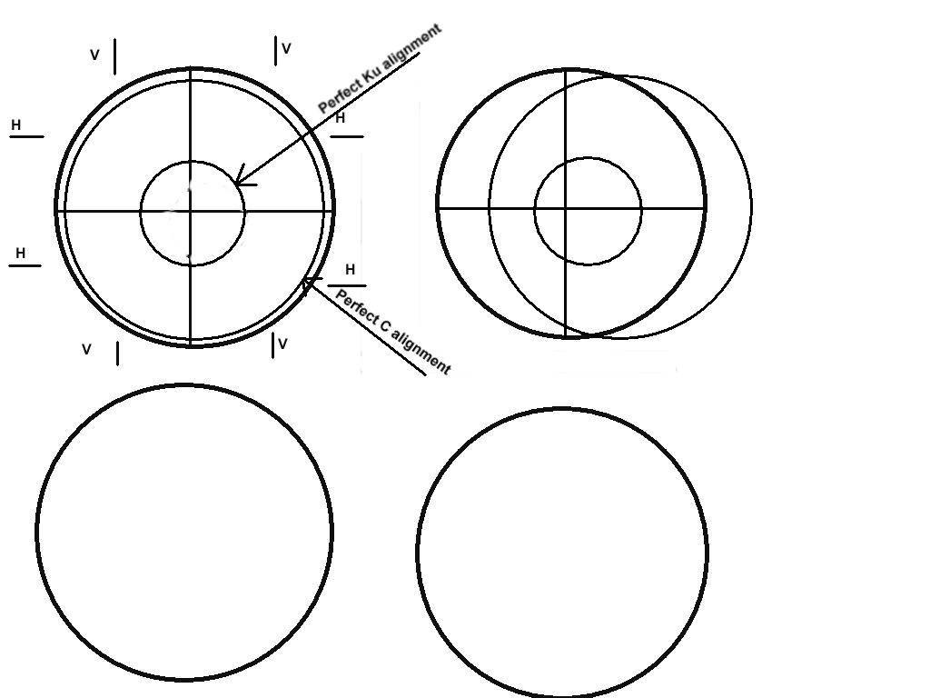

I have a theory about what is happening on my skew. I hope the drawing helps us all to understand what we are trying to achieve in tuning our dishes. I am not the best draftsman in the world, so keep that in mind when viewing my drawing.
First remember, that the Birdview dish has almost perfect surface accuracy, and it's parabolic form is nearly perfect too. It is also a very flat dish, .41 - .42 F/D ratio.
The factory Focal Length as measured by me from the center of the dish to the mouth of the OEM feed-horn was 39-1/4". I now have the Focal Length set to about 40-1/4". Using 6'5" as the viewable area on this 6.5' dish, the calculated Focal Length is 41.1". If you use the entire 6'6", the calculated Focal Length is 41.9". For now, let's go with the 41.1" Focal Length.
Keep in mind that this dish was designed for C-Band at the time it was made, so in my opinion they set the FL shorter to avoid side-lobe interference. Remember the time I thought I had a signal on G27 C-Band with the Perfed dish? It turned out to be the signal from G13 bleeding over. It was as nearly as strong as the signal on G13 itself. That's the problem you run into with these super gain flat dishes.
So my theory is that not having the dish centered on the arc properly coupled with the fact that I have increased the distance from the LNBF to the dish, I still have very strong C-Band signals, but the Verticals are being cheated so to speak. Especially on the Center and Eastern side of the arc. I have good lockable SQ on NASA at 137W, and the verticals on G15 are nice and strong and lockable, but there, the Horizontals are a little weak.
The Ku would still be quite strong because of the accuracy of the dish. Here is the drawing to illustrate my point. I left some of the circles blank for further illustration, or for another draftsman to pick it up and add to it.
I may be completely wrong, and if so, please correct me. I know if Mike Kohl sees this and I am wrong, he will jump in to bring me back to reality. :) He has done it before in phone conversations. :)
So jump in here and write some thoughts.

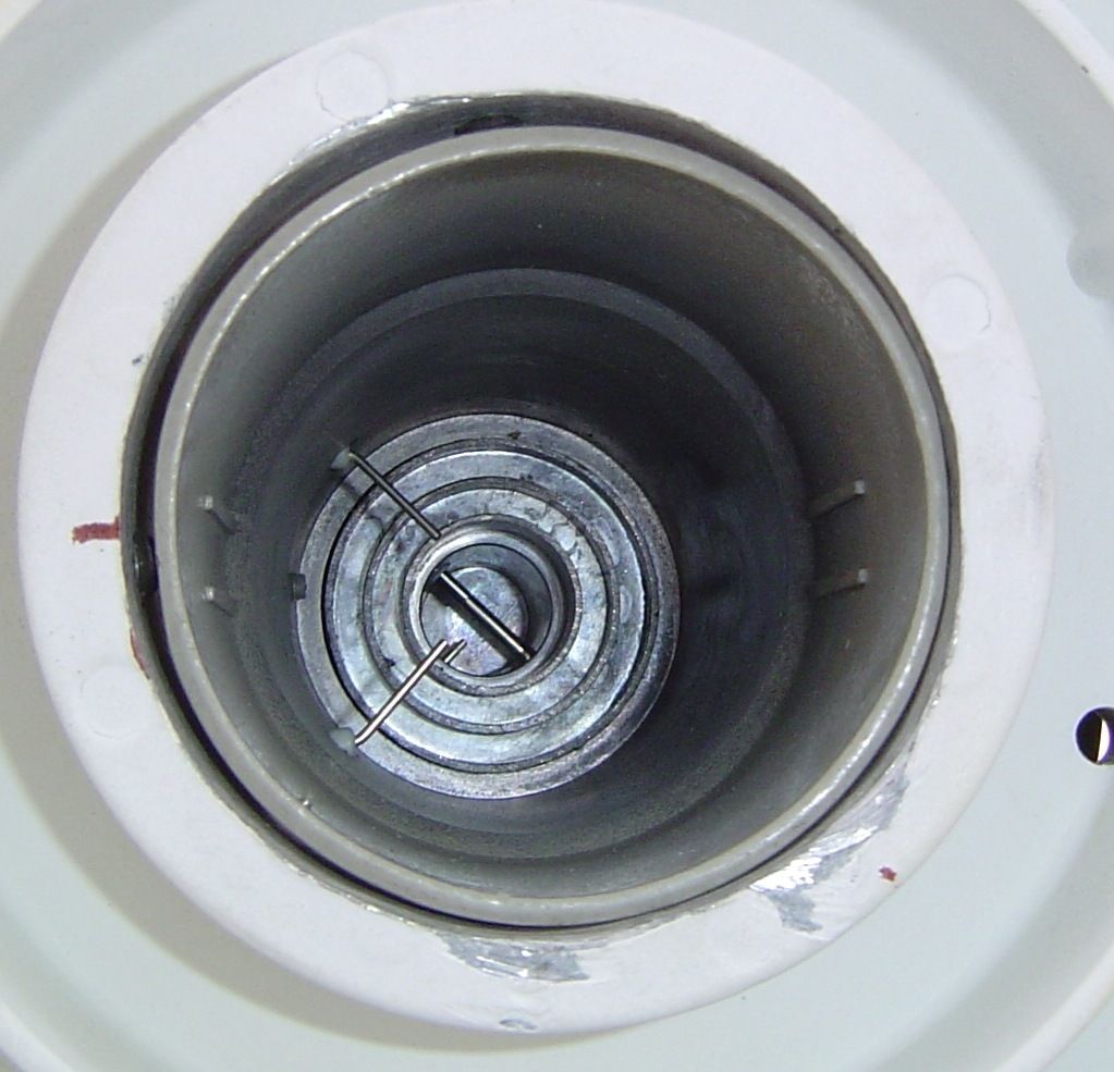

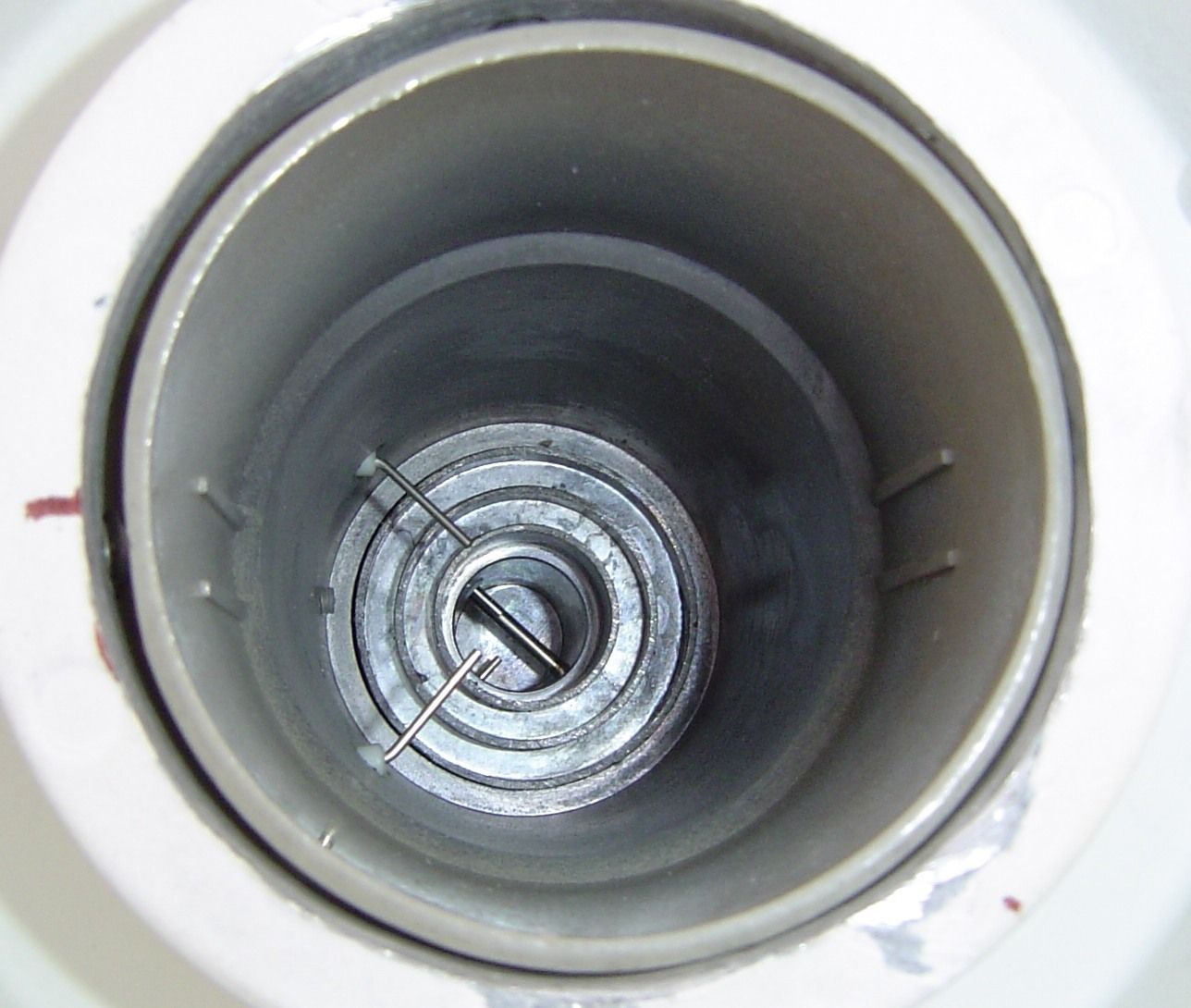

I took a couple of pictures of the throat of the CK1 so everyone can see the inside of it.
Interesting that the CK-1 lnbf does not have an isolation bar for C-band. Just the c-band probes then the internal ku scalar ring. Ku part has an isolation bar. Hmmmmm.

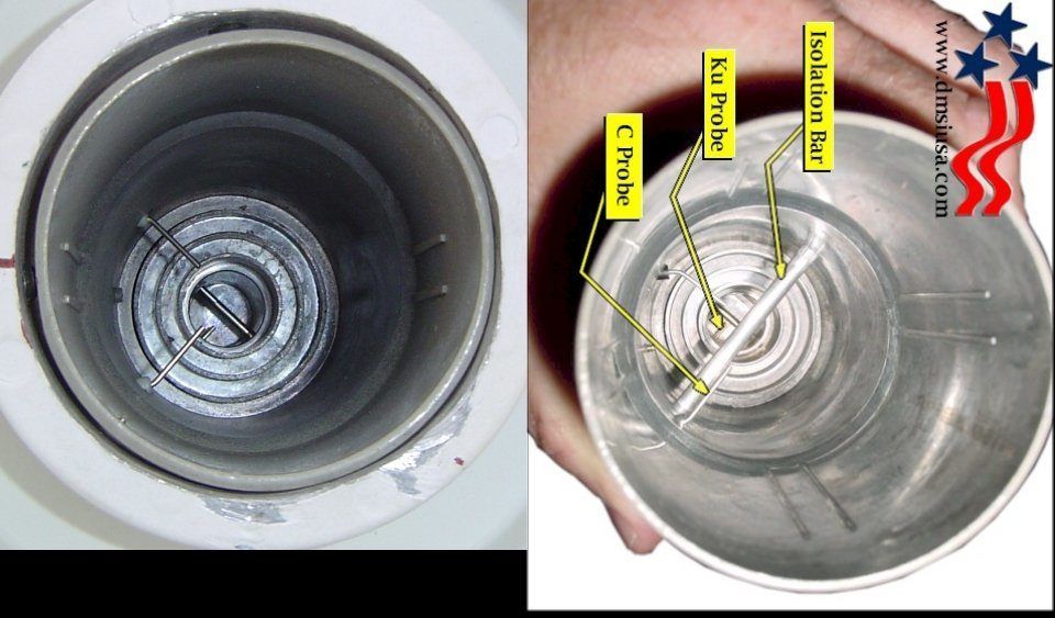

well i've been working and modifing my BSC621 as Truckracer noticed the isolation bar for our bsc621 c-band part covers the ku probe in the area that should be the focal point for ku. so i removed that bar. but when i went to the tech bulliten on the BSC621 to make sure my alignment was correct. it shows the ku probes just the opposite from the CK-1 so maybe the is why your having trouble with several receivers ?
just a thought
I rotated the image so that the probes match and after doing that, they look like they are both aligned the same.
See the picture.
EDIT: Where does the external arrow line up with the probes on the BSC-621?
I would suspect they are both lining up the exact same way. They are just using two different locations for the arrows on the outside.
