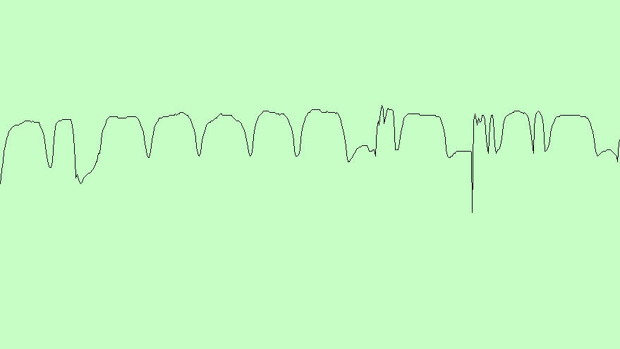

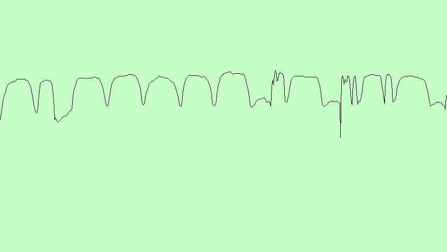

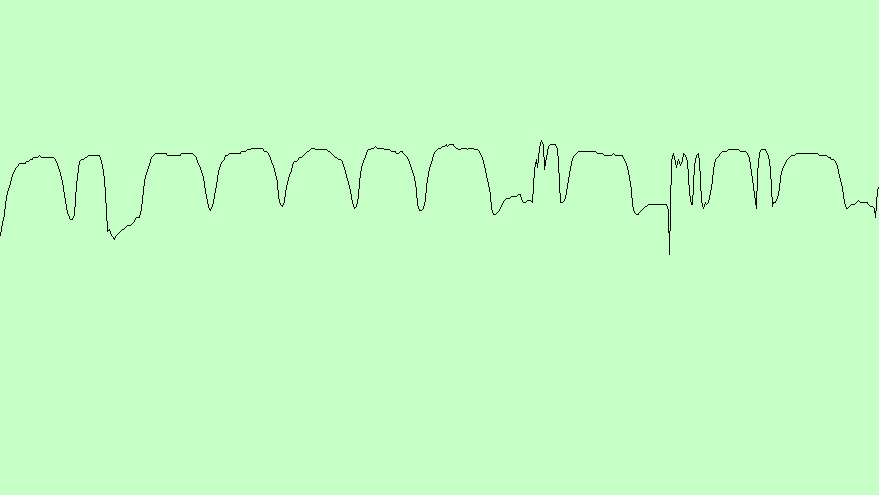

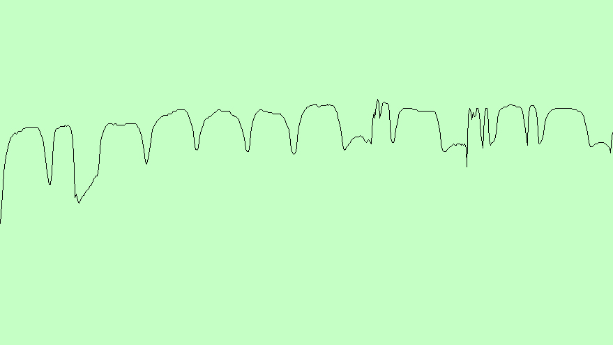

Anyway, I thought this would be a good time to do an experiment. I put my C-band dish on G17, and ran a series of spectrum scans on horizontal.
Basically, I did 4 different scans using my Broadlogic 1030 with Hans blscan.exe program, and displayed data using a VB program I wrote. The 4 scans were:
(1) No splitter, ie direct to LNB (through a channel master meter to insert power)
(2) Using sat rated splitter, power pass to analog receiver.
(3) Using 30 year old RS Archer TV splitter UHF rated
(4) Using a sat rated 4 way splitter, power pass to analog receiver.
Each scan is displayed with a vertical range of zero-100%, horizontal 3700-4200 MHz. I could have zoomed in on the vertical, but wanted to show the raw images.
Ok, then the 4 scans shown below:
(1)
(2)
(3)
(4)
Now, looking at the various scans, the first thing I'd comment on, is that while the 4 scans look almost identical, scan (3) with the cheap TV splitter does show a drop off for the first 40 MHz, but it's primarily a dropoff of the background noise, not the signal itself. Also, there is a slight decrease in scan (4) relative to the signal-background level, but it is no where near what you'd expect from the loss ratings of the splitter. They are really hardly noticeable.
Also, I compared the UHF splitter to the sat rated splitter relative to S/N readings with my TT3200 receiver on the first (CW) signal to the left, and with the UHF, I got 18.2 dB S/N and the sat rated splitter gave 18.8 dB. Again, hardly any difference, and in fact both were varying more than the difference between the two. So basically, the only transponder where there is any difference in the appearance of the spectra doesn't give any issues with respect to locking the transponder, as 18.2 is extremely high for the TT3200. It will generally lock signals down below 5 dB, and will lock S2 signals above 9dB. So I really don't see much problems with respect to using this extremely old TV style splitter.
OK, that's the results. Now my opinion is that would I recommend using a splitter rated above the 1450 MHz top of the band coming down from the LNB? Yes.
