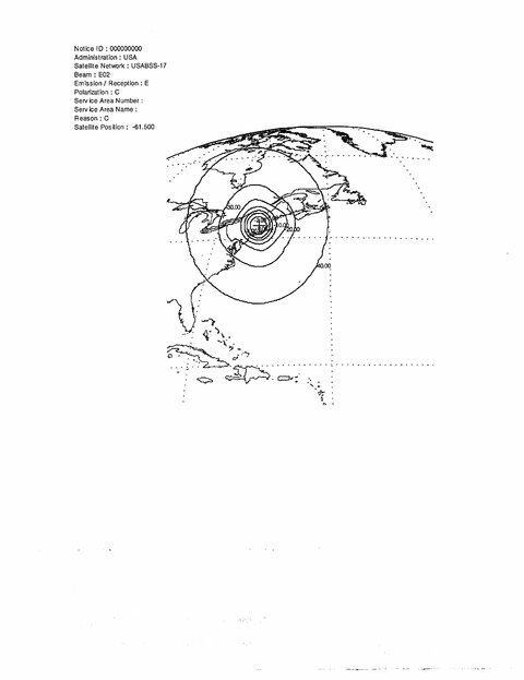

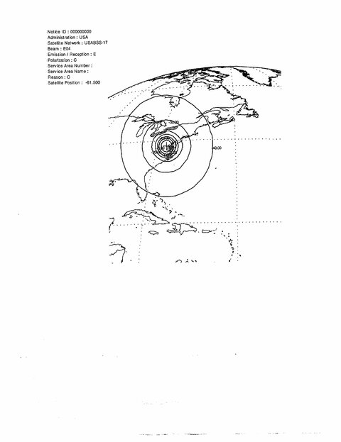

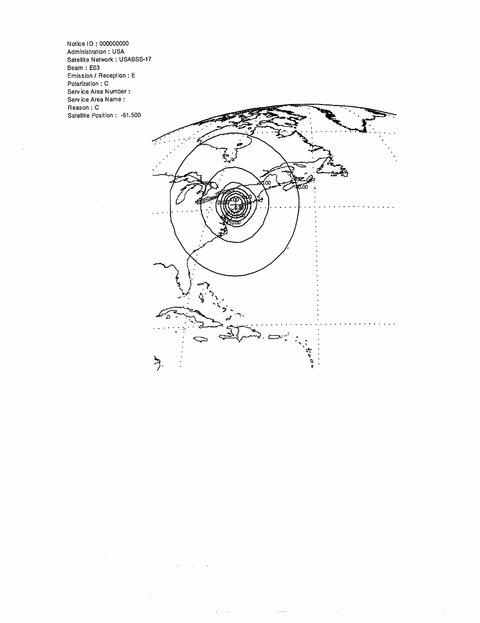

LATITUDE: 42.643. LONGITUDE: -77.056. That is the Penn Yan, NY Airport and I am 2 miles east of it. Thanks.
E2 @ 72.7W/42.8N
E3 @ 74.9W/41.1N
E4 @ 77.6W?38.6N
I extracted these for your from the Rainbow FCC permit. I doubt you will see this detail anywhere else since that permit's details do not exist in the FCC digital database and were very difficult to obtain. You should be able to get reception out to about the -20 dBw isobar with something like a 6 foot diameter antenna. Hopefully, I will be getting some missing data that will enable very accurate mapping.
Thanks for the maps. Jim S., I had earlier heard some problems for Scranton DMA customers not getting the HD signal. I am thinking that the edge of Spot 16 runs east of you and just west of Syracuse, and then all the up through New England. Spot 15 runs from Fayetteville, NC to Buffalo.
