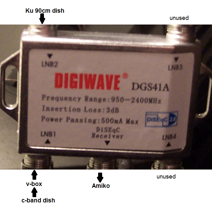

After many delays and setbacks I will finally purchase a STAB HH90 dish motor this week for my GeoSat Pro 90cm. I see a few on e-bay, however World Wide Satellites also have them. Any other sources out there?
This will introduce a second motor into my system.
Currently, the Amiko connects directly to the v-box, the v-box to the receiver port on the 4-way diseqc switch.
Should the v-box be on port 1 of the diseqc 4-way instead of on the receiver port? This way the Amiko would be directly connected to the receiver port of the 4-way switch and diseqc commands will be routed to both port 1 and port 2?
Or setup USALS for the 90cm dish and diseqc 1.2 for the c-band dish?
(Thanks Fat Air for helping me visualize this last summer)

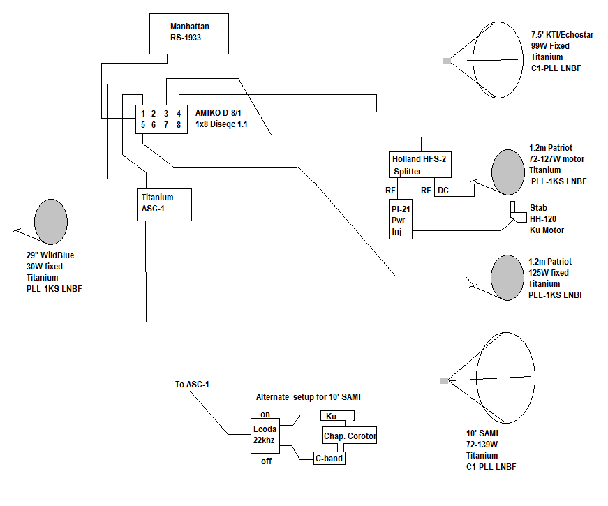

For the least amount of signal attenuation, I rewired to:
Receiver--->8-port Diseqc switch----- Port 1- C-band actuator controller; Port 3- Ku dish with Stab HH-120 motor
Here is a diagram of the current setup:
The only problem with this is the power for the Ku motor now goes through the Diseqc switch. I've been trying to figure out an external power supply that will work with my setup without modifying the motor. As shown in the diagram,the PI-21 power injector and splitter didn't work.
