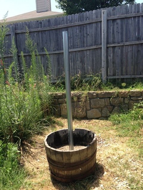

After a year of waiting a and planning today I started my install of my 1.2m dish ImageUploadedBySatelliteGuys1371750839.218576.jpg
Nice mount :thumbup:
What did you use for a pole? I used a chain link fence post and filled mine with concrete. Works great with the Geosat Pro mount. It's a great dish.
Bill

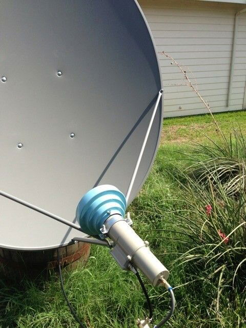

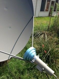

Got the dish mounted and can get 67% signal but no quality ImageUploadedBySatelliteGuys1375372003.919466.jpgImageUploadedBySatelliteGuys1375372043.575510.jpg
Does it look like its aimed correctly for 97w for 32.75n 97.488w. Fort Worth Tx
No. It "looks" like you are aimed at the west coast. Need better Pics.

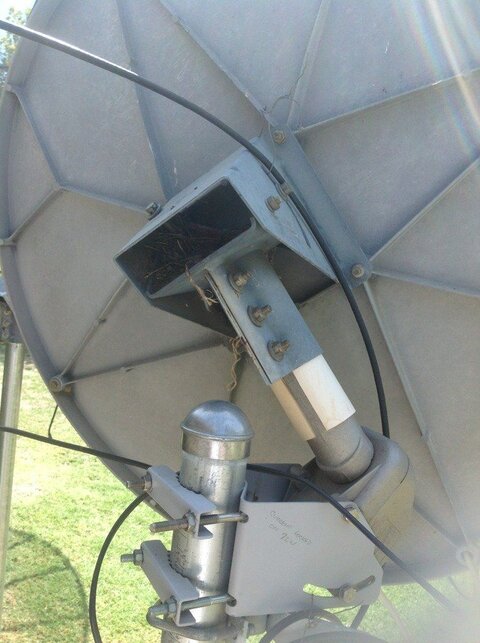

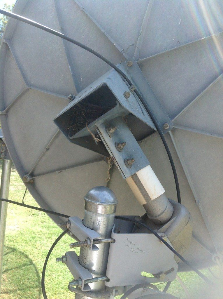

got the dish aimed today the elevation was to low and some how the dish was twisting on the motor shaft
Oops!
If the dish was aimed too low, it hints that the larger diameter 621 was mounted too high.
This is a common problem, and often ignored to the detriment of signal reception.
If the dish or post is twisting when you put the dish on the post, you have a BIG problem. Nothing is going to stay locked if either is moving when you don't want it to. If the motor shaft is not locking down tight on the dish then you may need to shim the motor shaft inside the dish mount with a short piece of plastic pipe?
I had to shim one of my Channel Master dishes to be able to mate it with a STAB120. Works great.
I think the whole motor brackets out of wack I can adjust the dish by moving the dish left or right a little and the motor mount that's attached to the pole moves to
Show us a good picture of the back of the dish where it's connected to the motor and the post/mast in the concrete.
You may need to shim it with a piece of plastic pipe like I did with mine. It's lasted for several years.
