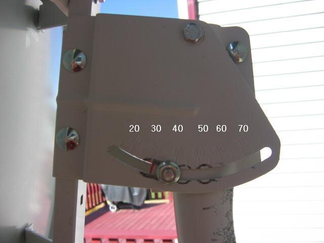

Last checking before I install. I have to set the elevation to Elevation = 31.4° according to the site http://www.emantechnology.com/lookangle.asp , right? what about the skew? does it still work if I left it to approximate 0 (my lnb's doesn't have any scales) , then once I get a signal, turn it?

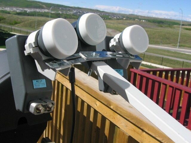

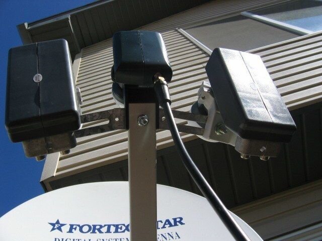

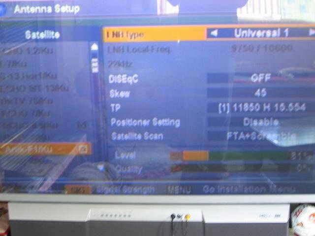

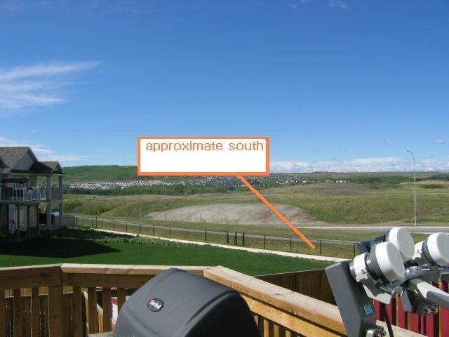

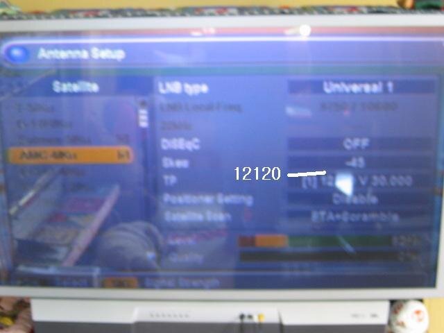

I am having trouble aiming at any satellites. Now, trying AMC 4.
Today I took some pictures of my setup to help explain myself.

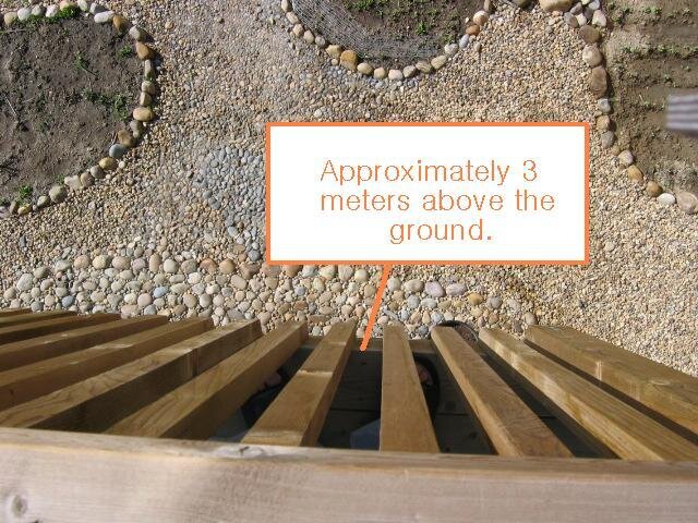

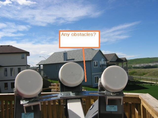

1. I installed my dish on the deck, which is about 3 meters high. Do I just calculate the elevation from online satellite calculator and adjust the elevation according to the site? While I was reading threads, I read one about offset. Do I have to take the offset and the height above the ground(3 meters) into account? If so, add or subtract?
2. Anik f1 is my closest linear satellite. How come in pansat there is only one tp for Anik f1?
3. My pansat is currently in factory bin. Should I upgrade the firmware?
I think my mast is leveled.. elevation set to 30.2... Fanned it (slowly, 1 cm at a time), still nothing. I can't find any problems any more...:(
Any suggestions would be greatly appreciated! :D Thank you.

It seems from your pictures that you do not have the motor attached as of yet. It might be best for you to simply try to hit any satellite (don't worry now about your true south satellite)... Galaxy 10 (123w) is a very rewarding bird, once you find the signal. And there are some very strong transponders there (the higher numbered ones)... Try 12114 (V) 4.444 msps... There are at least two channels there, they'll help you point the dish. Once you find the satellite, you can change to the lower powered ones to fine-tune your azimuth and elevation settings on your dish. Not sure how well an 80cm dish will work on the lower powered G10 transponders from Canada...
Also, since you don't have the motor installed yet, you would set the elevation (move the dish look angle up or down) from the marks on the dish mount clamp and use the settings for a non-motorized installation. You will also have to skew (turn) the LNB to get proper quality. If the satellite you're aiming at it west of your true south position, you'd turn the LNB in the holder clockwise (looking from behind the dish) or counterclockwise looking from in front of the dish, from center. Just loosen the bolts that hold the LNB and turn it slowly in its holder. Turn it a little at a time and step away from the dish to see if you get signal quality...
Height above the ground means nothing... Just make sure your mast (mounting pipe) is completely level.
Up on your deck isn't really a factor aside from it helping with potential Line of sight issues. Looking at your pics it looks like you are fine for LoS.

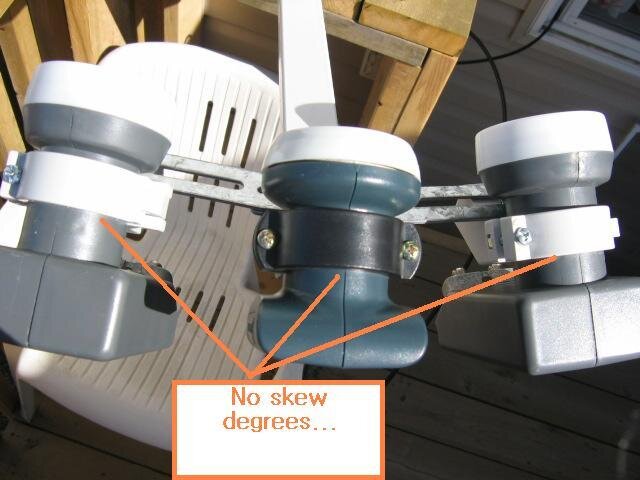

One thing I did notice is that the Skew setting is being used. You don't need that. Your LNB won't use it. That being said, I'm sure it won't effect you at all.
That Fortec LNB is universal:
http://www.sadoun.com/Sat/Products/Fortec-Star/LNBF/FSKU-v04-Fortec-Star-Universal-LNBF.htm
So you'll want to use 9.750 / 10.600 when using it. I'll attach some screen shots - hopefully the information is usefull (I'm using a Universal LNB as well).
It looks like your LNB is setup right - try setting up TP1 (11749V) as per my pics.
