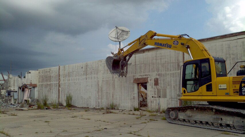

Please...for I have spotted the holy grail.... 1.8m Prodelin... :eek:
Liked to have crashed the car turning around to go back to ask, demolition guys said they had to ask the boss if I could have it...I have to go back tomorrow to see, I offered 50 bucks for his time....we shall see.... :D
Reactions: ThisBUDs4U

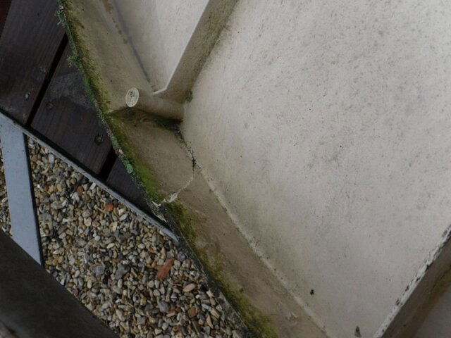

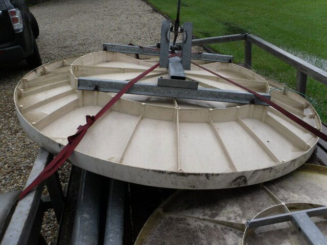

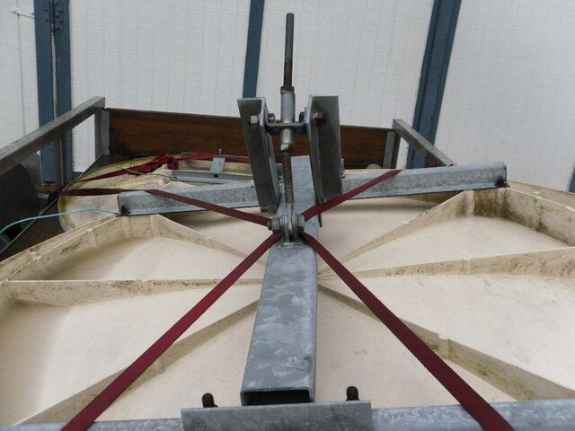

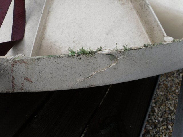

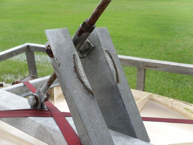

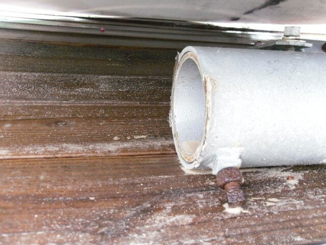

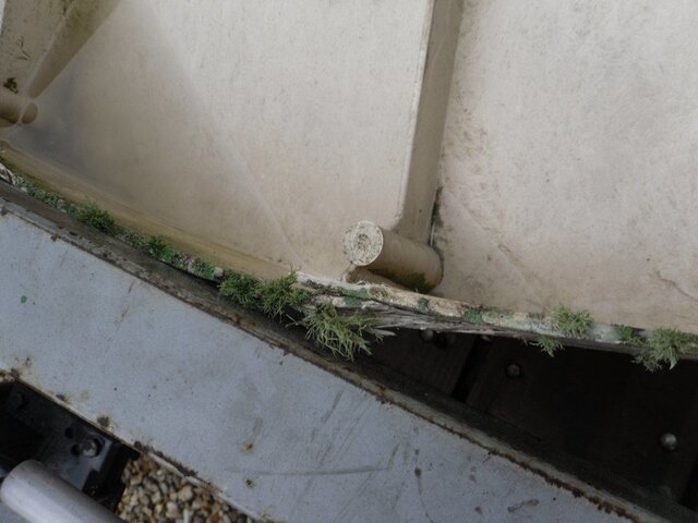

Well it worked out pretty well. the operator had to end up pushing the wall down, as the dish wasn't on a NPRM, it was bolted to the wall. When the dust cleared, the only damage was to the rim of the dish, not affecting the parabolic shape at all. picking it up out of the rubble, he bent the elevation adjuster, and broke the mount sleeve off the mount of the dish. All can be fixed pretty easily, I think. LNB arms weren't bent at all. Feeds were intact, no damage.
Sorry no pics as it was coming down, I was too busy paying attention to him...LOL

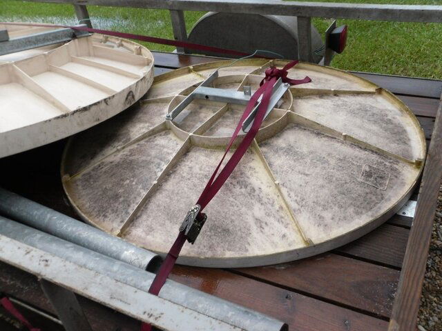

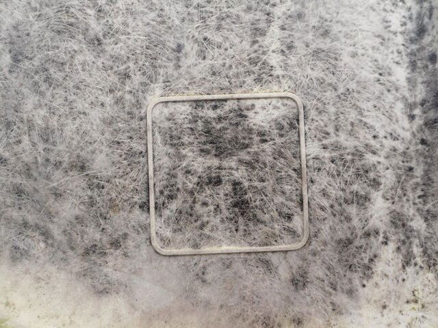

...and, not 50 feet away...was another dish. 1.2m. Operator asked me if I wanted it, I told him 20 bucks more if he could get it down without tearing it up...down it came. This is an older dish, its real weathered on the back, fibers in the fiberglass are showing, but it looks ok otherwise.

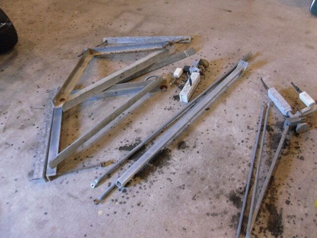

I also included a pic of the arms and LNB's for both, as well as the twisted up metal that was left of the 1.8m dish wall mount.
On the rim damage, some JB Webb on it will reinforce the dish, if you are concerned about it affecting the dish. Put on the inside side of the dish.
Did some work today, got the cracks patched with some Bondo for fiberglass, here's the 1.8 first. Still needs another coat of paint, but it looks better.

I though you'd commented previously about the fiberglass shredding a little.

As for painting the back of the dish to encapsulate the shedding fiberglass, I used Krylon Fusion for that task.

Nice work there, if that was all the damage he could do with that big ol Komatsu, lol.
