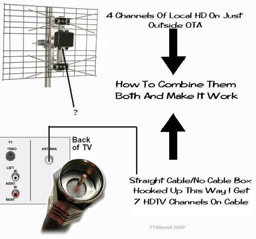

My cable company has about 7 distant HD channels coming through the cable line minus the cable box. My plasma HDTV has got just the cable line going straight to the antenna input of the TV. There are 4 local channels that are OTH and I would like to combine those with the cable's HD channels.
One problem, the plasma HDTV only saves one scan at a time! In short, if I scan looking for new channels it finds all the TV regular channels and the 7 HD distant channels they offer then saves. If I unhook the cable and go HD OTH Scan, it starts all over and saves only the HD OTH 4 local channels it sees just on the antenna outside! Basically one or the other!
Is there any way to split the two, cable and outside antenna signals together so it will scan the cable distant channels plus my OTH local signals on the antenna and save all HD plus the standard channels it sees? There are 110 regular channels also it scans before it scans digital channels on cable. I would love to include my OTH antenna with the cable scans if it possible!
The question is if it can be split will the TV scan the outside antenna for local OTA channels as well when it scans the HD channels in the cable line?
Any suggestions welcome!:)
You'll have to settle for one or the other. Cable uses a different tuner built into the TV for cable channels. Over The Air (OTA) uses a different tuner to pick up different frequencies and both OTA and CABLE can't be tuned at the same time.
