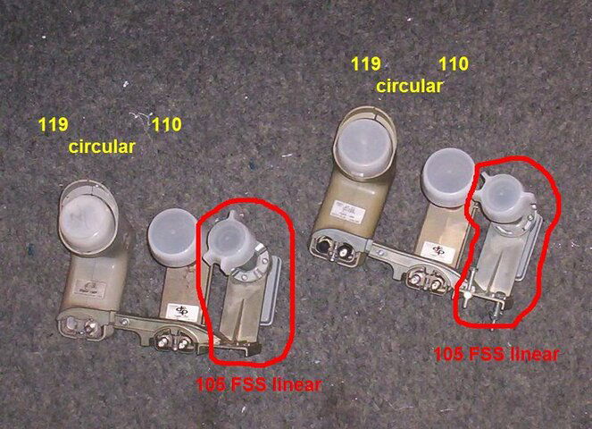

If you have some of the removed LNBs from your super dish 105's especially , I would like the feed horns (if not the whole LNB with feedhorn).
PM me if you have any.

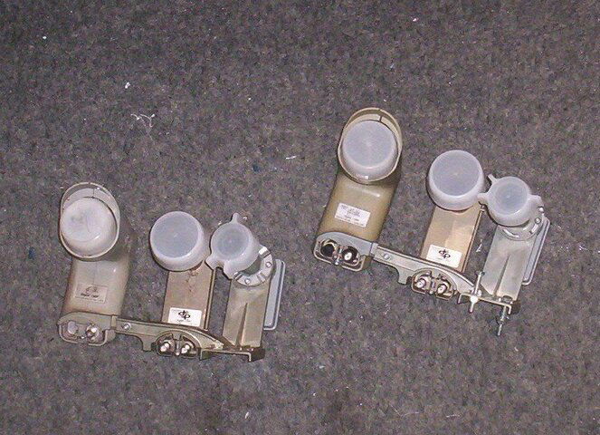

And hey, I need the opposite part - the stacked lnb! ... maybe these mods would work out for everyone if you're willing to share parts ;)
Yea, I'm all for sharing the goodies. - :up
But, I've asked several times in threads like this, and PM'd a few others who were discarding or taking apart the 105's, and have gotten no positive reply.
As for you, Lumpkin, the FSS LNB off the 121 Superdish would be just fine if that's what Bob is converting.
And while we are at it, send Tron a few of the FSS LNBs, too.
Or I will if I wind up with too many.
He seems to like 'em. - :up
Shipping little light things like these via US Post Office Priority Mail is cheap, fast, 'n easy.

anole: here are the lnb assemblies i have. is this what you need?
Yes, thank you. - :cool:
PM sent.
I appreciate the help, and I'll pay it forward (help others). - :up
