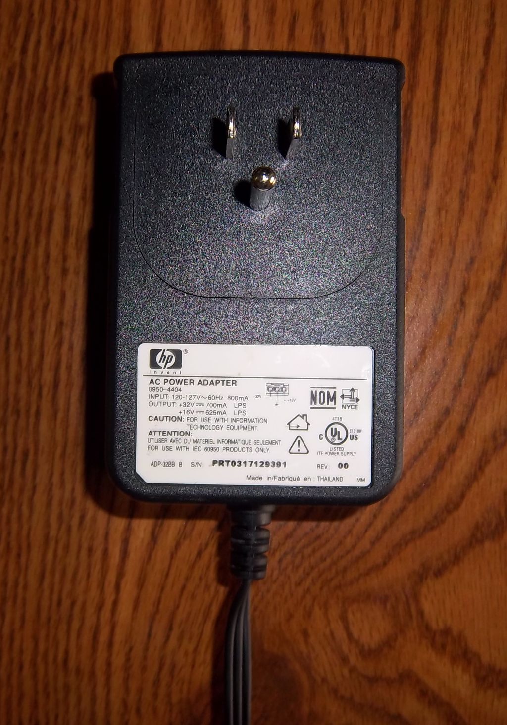

I had an old HP printer adapter (32VDC @ 700ma) in my junk box and use it for testing.
