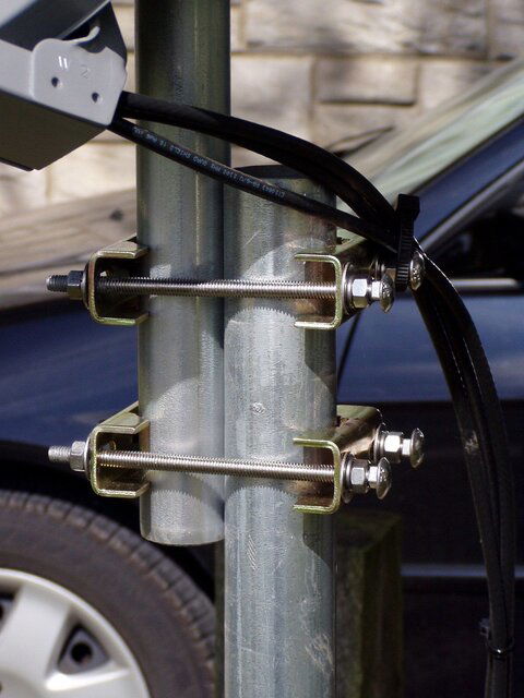

2" O.D. is indeed an odd pipe size. Galvanized chain link posts, the one I used was called a dock post, are 1-5/8" O.D. and are just fine for 300/500/1000 series dishes. The Supers were the only ones to use the 2" pipe and to mount a new 1000.2 I had to adapt a small section of fence post to the old Super's post. You might be able to do something similar or sleeve a smaller diameter post.

2" is not an odd size it is the size they use for conner posts. THe 1 5/8" is the line posts. It also does not have to be exactly 2" post if you find something that is a bit larger it will still work. Some heavy pipe like black pipe will be close, but it's not cheap.
