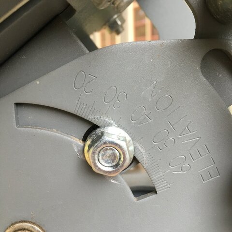

So when trying to adjust the elevation, do I just set 47.3 underneath of the nut??? There is no hash mark as to wear to set the number. The pole it is mounted on is plumb.
Also, when setting the azimuth, it calls for 209.8 degrees. Do I set it 10 degrees greater??
The edge of the slider, to the right of the nut.
