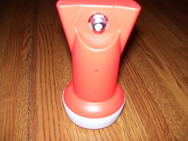

Had the privilege of trying out a new LNB (always like to try new stuff). This is a TechSAT Tracker II+ LNB from WS International (wsidigital.com) that works really well. I had tried out the Tracker I a while back and liked that so I was hoping to get the same results with the Tracker II. I would not be let down.

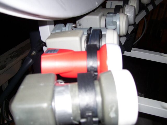

When I took it out of the box I noticed it is a rather small LNB and it is also a Standard so it should work fine in any setup. Although the color of the LNB is red. But I guess the color will have to do. I have a .4 LNB on my motorized so I took the signals from various satellites and then went up and swapped out the LNB ot the Tracker II+. Went through the arc and was VERY happy with the results. The Tracker II+ says a noise figure of .2db and you can see the results. Compared to the .4 I had, I gained a couple points across the board. But what made the LNB shine was that the signal was stable. I was using my Pansat 1500 which has a very spazzy meter. On other LNB's I tried, the signal would go from 60-75 back to 62 back to 76 etc. The TechSat did keep the meter more stable. Yes it bounced but not as much which would make aiming a dish easier.
So Now I tried it on my T90 dish. First thing I did was try 103 and its crazy skew. I was very impressed with the results. The news feeds on 103 are at lower power than some of the other channels and the Techsat pulled in 3 feeds stable that a couple other LNB's could not (one was a .4 and one was a .3). I then went to IA5 and gave me very good results. I tried AMC3 and AMC9 with great results. I had two other LNB's that are a .3 and the Techsat not only gave me a few extra quality points across the board but also made the meter more stable which was very nice to see.
I could sit here and type up every satellite and the results between the existing LNB and the Techsat but that would just waste space and time. You will see a few points gain on each satellite. Some feeds came in more stable with the Techsat and the existing channels it gained between 1-5 points on the Pansat

All and all I am very happy with the results and now have 2 of these set up on the T90. With its smaller size and stability on the meter, these are a keeper...now if we could do something with that red color ;)

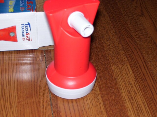

I had the same thought. In fact, for fun I busted one open (took the cover off) and its some good metal inside :) I was very happy with the results

Iceberg that looks like it would pop right in on these primestar dishes' lnb-holders, correct size for that??
nope. It has a 40mm throat and when you crack open the case there is very little room for a 20mm throat inside. The guts of the LNB are right up against the eye.

good to know about the dual version. I moved one of them on the T90 to 97W today and saw a couple point gain over my older one :)

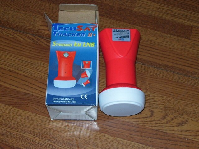

--Hi, all. Lately I had been having trouble with my Motorola DSR-922 4DTV receiver on the KU side/X4 satellite. Lately, either nothing had been coming in, or I was getting several channels with the same program on them. Anyway, I decided to just buy a new LNBF, hoping that was the problem (doesn't hurt to have a spare LNBF anyway). Lo and behold it WAS the LNBF and NOT the 922 receiver.
--The LNBF I purchased was a "Techsat Tracker II+" (Standard, not Universal) distributed by WS International, with a noise figure of .2dB. The first thing I notice is how red in color is really is, haha. Just for the heck of it, I weighed it. The old LNBF (.4dB noise figure) weighed 4 and 1/2 ounces. The Techsat Tracker II+ weighs 3 and 3/4 ounces. Basically, I weighed them just for the heck of it, but I figure the less amount of weight on the LNBF holder, the better, even if it is only 3/4 of an ounce less.
--I did a signal quality test on the IA5 satellite (using my Mercury II) and X4 (on Motorola DSR-922 4DTV), and both receivers realized a 15 point gain in signal quality, which is better than my old LNBF ever had. I recommend this LNBF to anyone who needs an upgrade to their old and/or ailing LNBF. In fact, tomorrow, I am ordering two more for a friend. Great price and performance....but I plan to paint it white.
