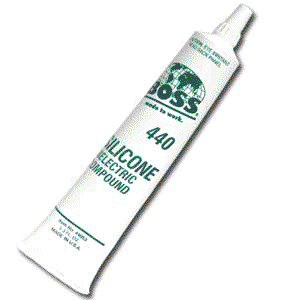

If you want to fill connectors to resist moisture, I have heard to use silicone grease as in the attachment.
Thoughts?
quapoharry, yes I was referring to RTV the hardening kind. I don't use it except for sealing coax on the outside wall of the house. I don't like it in or on connectors. The silicone grease is a good idea but regarding this topic we still need a apparatus such as a cap to cover an open port and then you could also use a 1/4" rubber O'ring inside the cap for a seal without getting grease all over. Grease would get pretty messy here in the desert heat as it melts and wicks, I know from having to deal with installers using it. I use that stuff on spark plug boots for easy release when doing tune ups on cars, also helps prevent high voltage leaks. There's nothing like leaning over a steel fender and touching a leaky spark plug wire...
