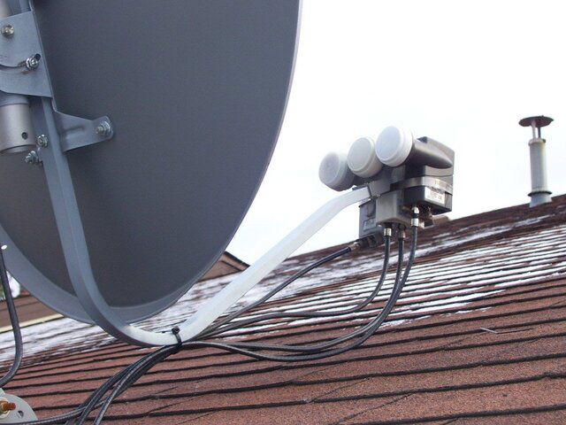

I just hoseclamped a DBS LNB next to my KU LNB and its worked fine for 4 years now :)
So if i mount a cirular LNB and run both LNB'S into a SW21 or DiSEqC switch I should be good?......I have an Dual output Marked BSS 12.2-12.7GHz,950-1450MHz.Will that work?.I also have a Dish N single If that would be better?..Thanks J-V-D
depending on your KU LNB and what shape it is, some DBS LNB's are easier to mount on there
I have a Sadoun dual which looks like a "block" LNB...the DirecTV DBS rests right next to it and a hoseclamp holds it together
The attached pics are when I had a Universal (for IS9 58W), the standard and a DBS....the Universal has since been removed

Mine is one of those little geosat bullet lnb's, very small.I might try to make a mount for it to attach to the support arm?
