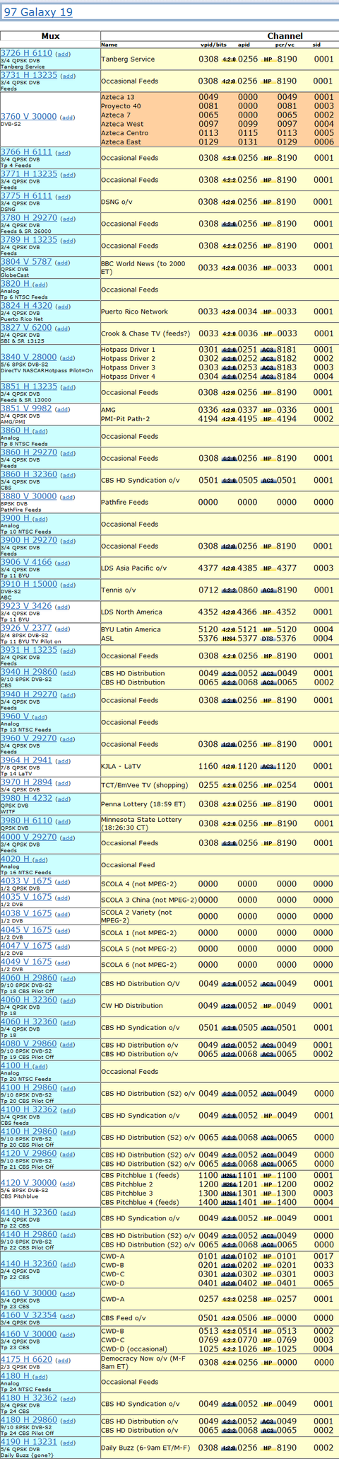

It's always easier to troubleshoot when you list what you are using, screen pic maybe?
CBSs TP info is listed on lyngsat.com
G19 4080 V 29860, DVB-S2 8PSK, FEC 9/10
Here, maybe this will help. You'll have to click on it several times to get to the full size.

At this moment I have 4.2.0 video on 4100 H 32362, Q = 75 on the S9. if 29999 is the SR, may be off enough to loose lock. According to your attachment the SR's used are 32362 or 29860 [:-)
