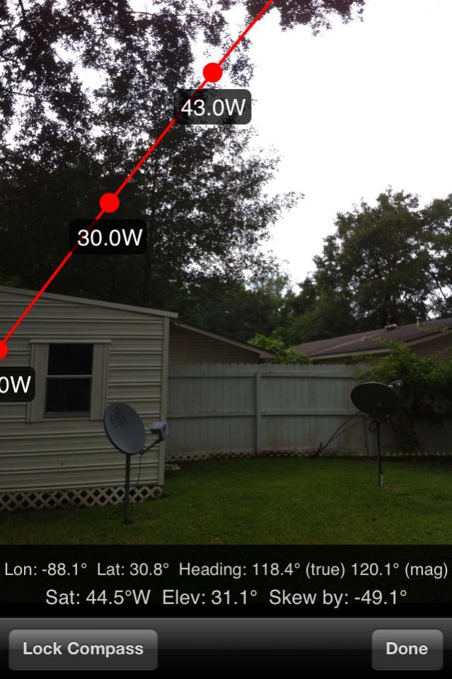

I can vouch for the app's usefulness, see the attached photo which tells me exactly which limbs are in the way, and the required settings to get what you're pointed directly at.
