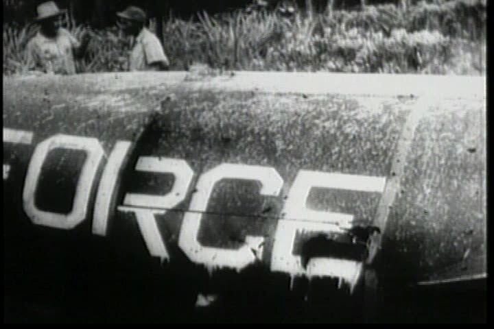

Some of the propaganda can be a hoot. Attached is a screen capture from a Cubavision documentary showing the smoldering wreckage of an alleged US AIRFORCE warplane laying in a Cuban sugarcane field.
Call my cynical, but I strongly suspect there is a wet brush and a bucket of house paint just out of camera range.
