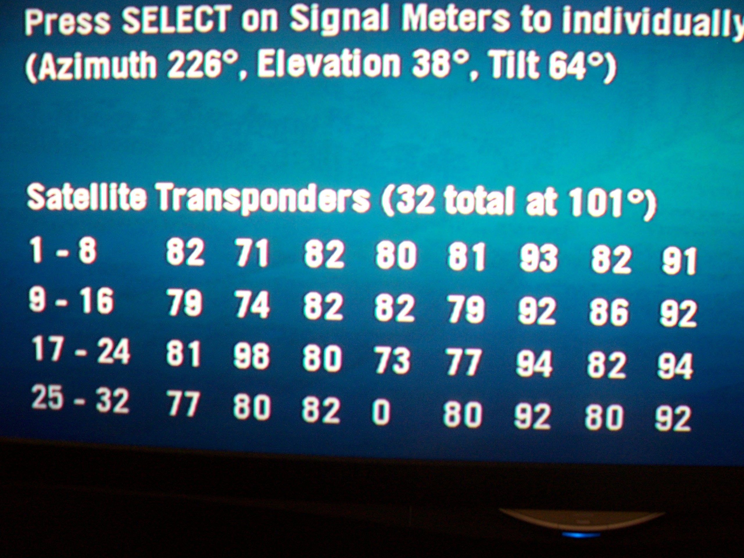

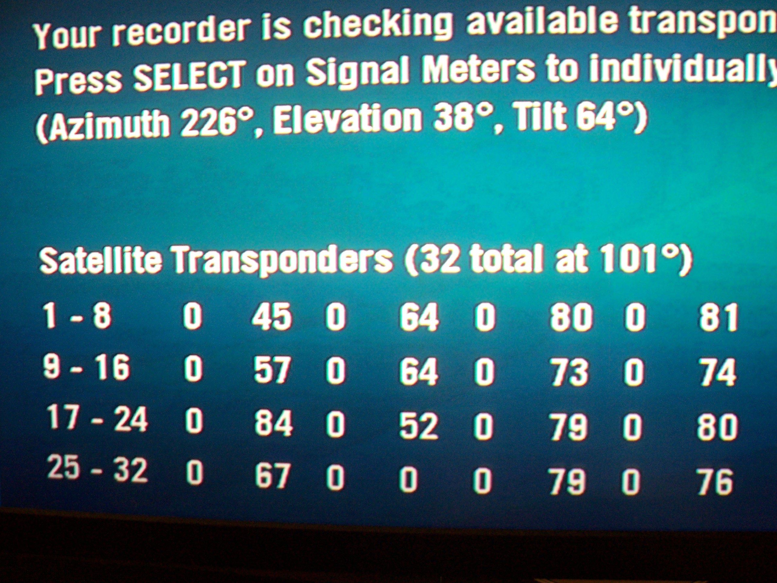

I just installed my HR20-700, and on tuner 1 I have decent strength all acrooss the board, but on tuner 2 there are a bunch of zero's and the other transponder signal strengths are much lower.
Is this normal, or is there an issue I need to correct.
On my HR10-250, the signal strength on both tuners was always equal.
Thanks! :)
Like Brewer said, switch the wires and see what your strengths are, because it is not normal.
Possible causes (in the order that I can think of them)
Bad connectors, bad multiswitch, splitter in line, RG-59 wiring installed, the second tuner was NOT connected on initial setup.
If the problem switches to Tuner 1, then it is a problem in the cable/connectors/multiswitch. If the problem remains on Tuner 2, then it could be an issue with the receiver. With the cables switched, do a RBR (red button reset) to see if that clears up the problem.
These are my readings from the 101:
Tuner 1
Tuner 2
Those readings look like a split or not all the LNB's are going into the multiswitch or bad wire. Switch them to see if does the mirror on 1.
