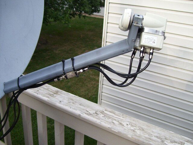

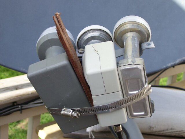

Globecast LNB's are cylinder like Primestar ones so the 40mm neck wont fit in the groove. You will have to take the plastic housing off behind the LNB (doesnt hurt anything) and find a way to clamp it down
2nd pic shows what I mean with the LNB casing

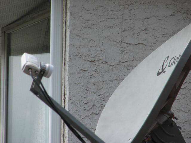

Do you have any pictures? Normally, LNBFs have a standard 40mm neck, and will fit in most LNBF clamps. Do you have a flanged feedhorn/LNB?

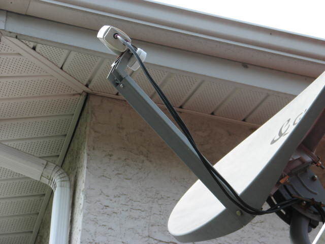

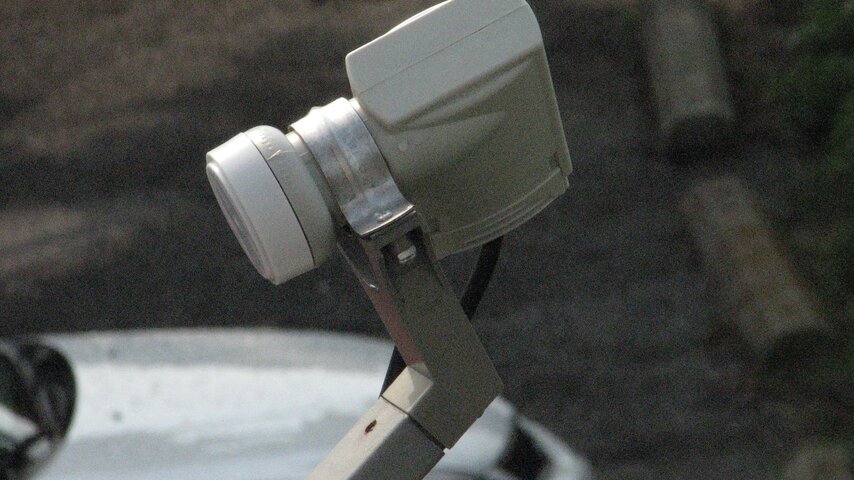

Thank all of you for your reply.
Here is what it looks like. i had it set to the required elevation and azimuth but still no luck. Am trying to get galaxy 19 (telestar 5).
is there something am doing wrong or missing?
tanx

Well, first off, the dish is elliptical, so it came with a feedhorn that matches the dish shape.
Your replacement LNB has a round feedhorn, so it isn't optimized for that dish.
Next, the dish is supposed to be skewed for best capture of the signal.
You have the dish not skewed, but you do have the LNB skewed.
I didn't look to see if you twisted it the right way - :confused:
What are your options? ... and hopefully, others will come up with better ideas...
Get an older LNB that has V and H outputs, and will bolt to your old feedhorn.
Hook the LNB outputs through a 2x4 or 3x4 multiswitch, and then you can feed up to four receivers.
Then, skew the dish properly.
Putting a bandstacked LNB on your old feedhorn is not an option, because the Globecast receiver will not work with it.
Okay , gang, what did I overlook?
There must be some better ideas! - :cool:
Well, besides totally replacing his dish with a round one, then using that JSC322 LNB... which -is- a viable option! - :D
No multiswitch required in that case - one output of the LNB to each receiver.
Didn't know that the Globecast dishes were elliptical Channel Masters, which are flanged. As Anole said, the original feedhorn would be great. The feedhorn from a Primestar should work. Since you can't add a stacked LNB from a Superdish, you could add a Hughes DirecWay LNB to it and it would work fine.
