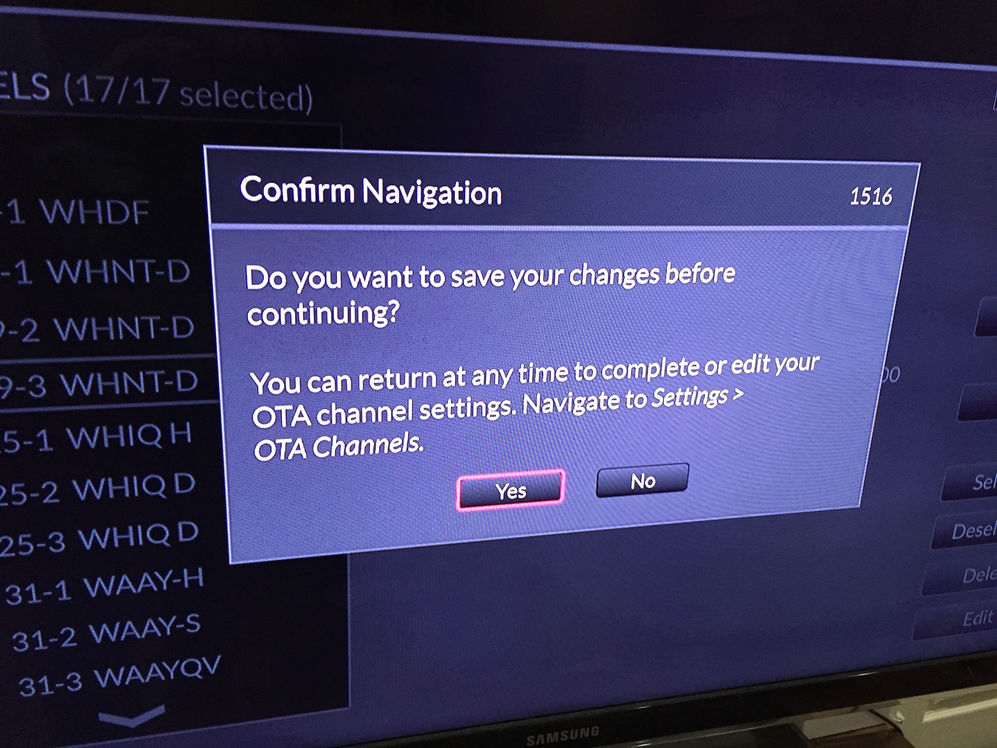

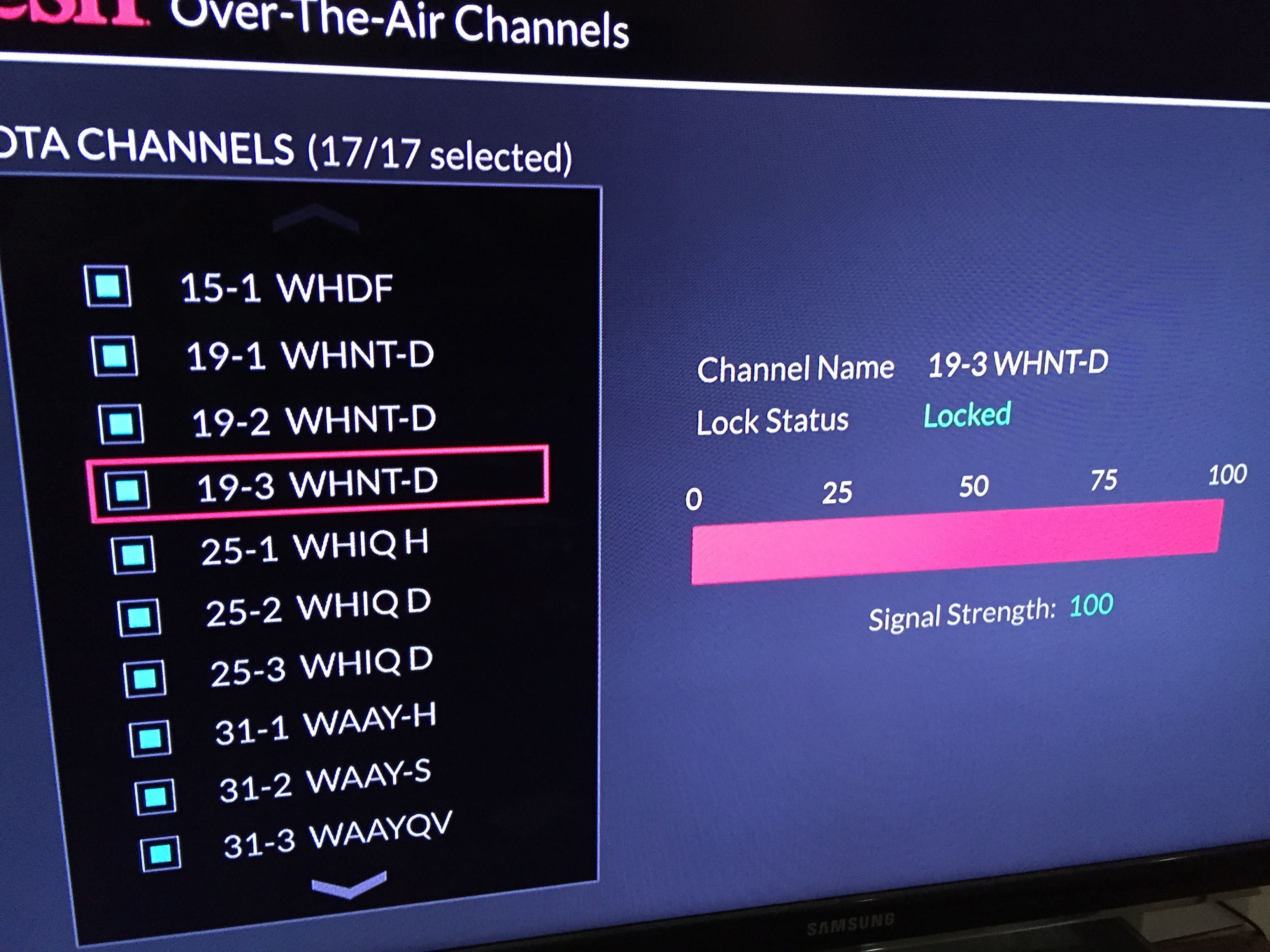

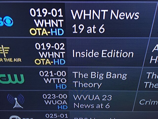

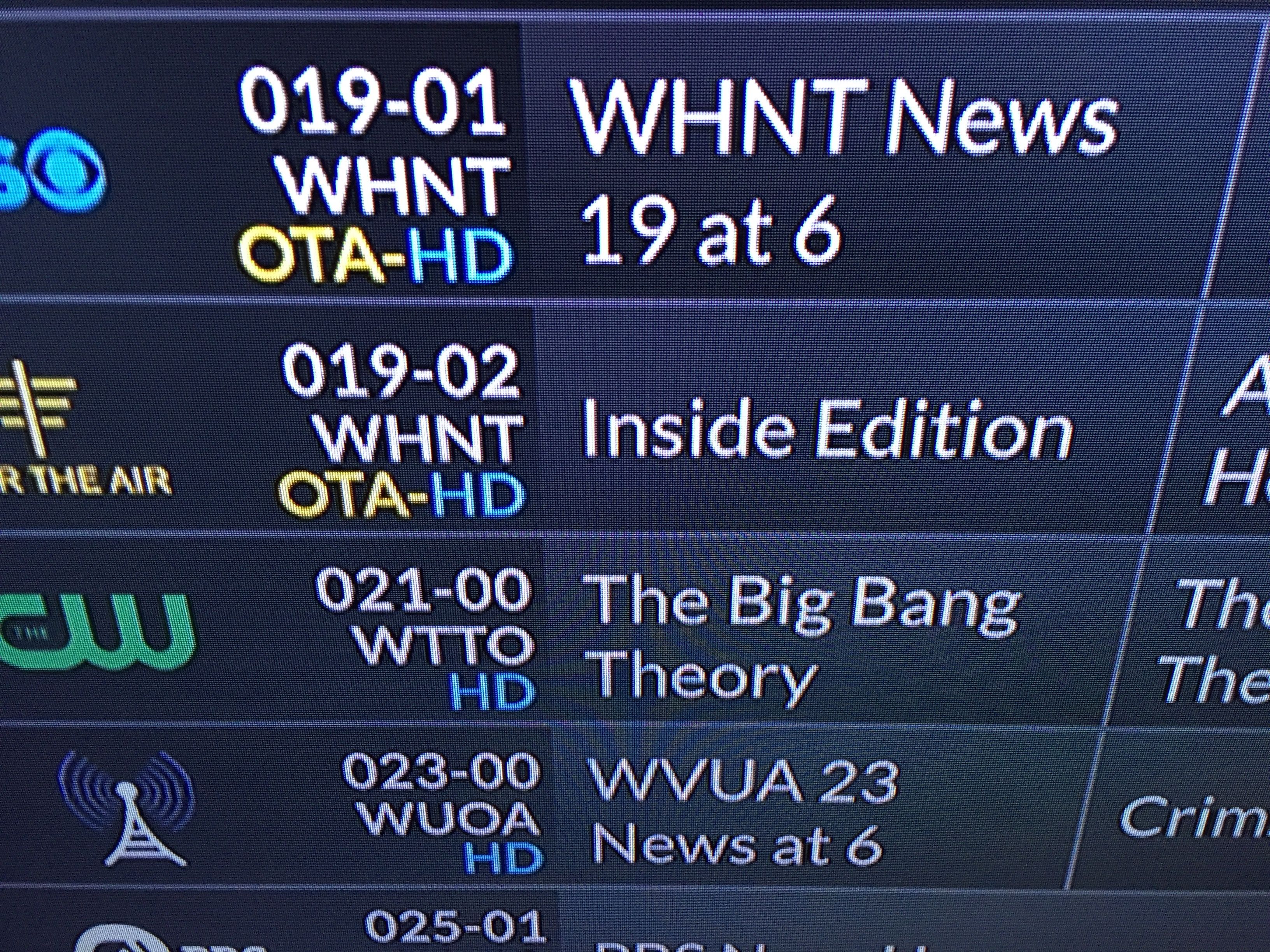

I've hit save a dozen times. It pops up to confirm then it doesn't do anything. The channel is selected in the list even after I go back to the page, yet nothing in the guide and the channel isn't there if you directly punch in the full number. Note in the images the lack of 019-03 in the guide after saving.

Also noticed that they added "HD", "SD", and "OTA-HD" to every channel in the guide. No way this missed this - makes me think they don't care - is EVERY OTA channel is labeled "HD".
