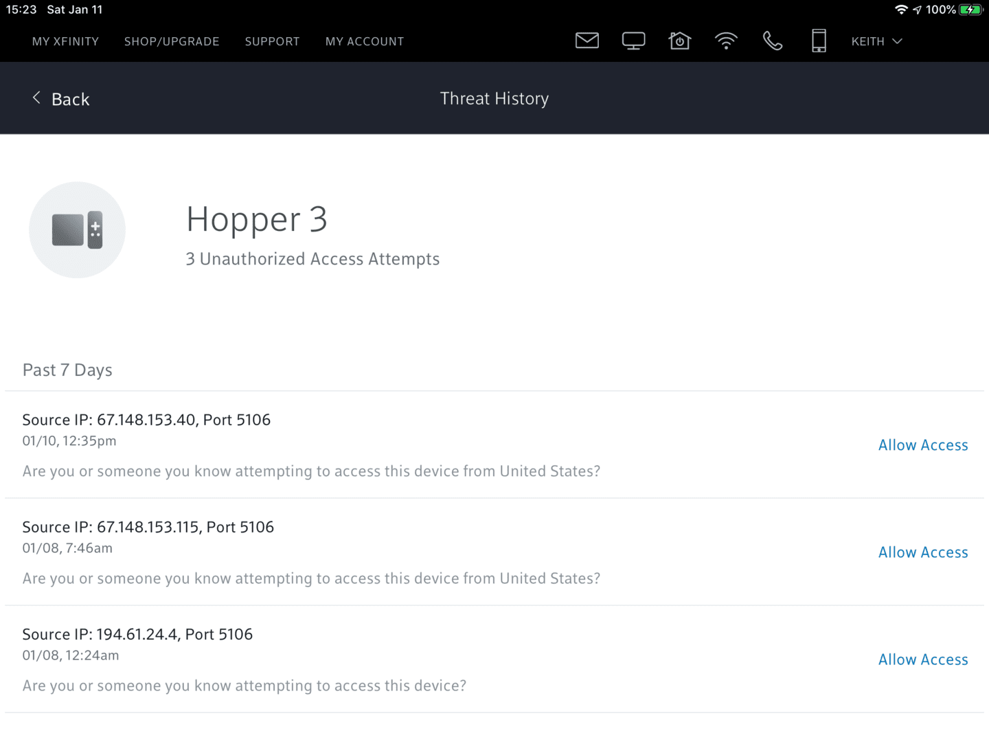

A few days ago, Comcast switched on their Advanced Security feature for 18 million broadband subscribers. Advanced Security is an enhanced firewall for Comcast's broadband gateways.
Since being switched on, Advanced Security has intercepted three unauthorized access attempts to my Hopper 3 device on my network. Each attempt was from a different IP address and on different days, but all three attempted to access Port 5106.
Has anyone else experienced unauthorized access attempts to their Hopper 3? What's so special about port 5106 on the Hopper 3?

The first two are Dish. The third doesn't seem to be. Used to have a network traffic analyzer on my network. I don't recall specifically if 5106 was the port that the Hopper was often using but it was something weird like that (I stopped using the analyzer about 18 months ago).
I wouldn't worry about it.
Reactions: medvyed
I've seen hundreds of unauthorized access attempts on an Allen-Bradly paperless chart recorder at work. I'm sure it happens more often than we know about, but in my case hackers realize they've broken into a brainless port-a-potty. Although I work for an organization the employs the fastest computer on the planet. Security is decent.
Fact that it's coming from different IP addresses makes it sound like it's random bots looking for holes and not likely an actual human trying to get to your devices specificly. Now that you have new firewall you know what has always been going on since before you had Comcast.
