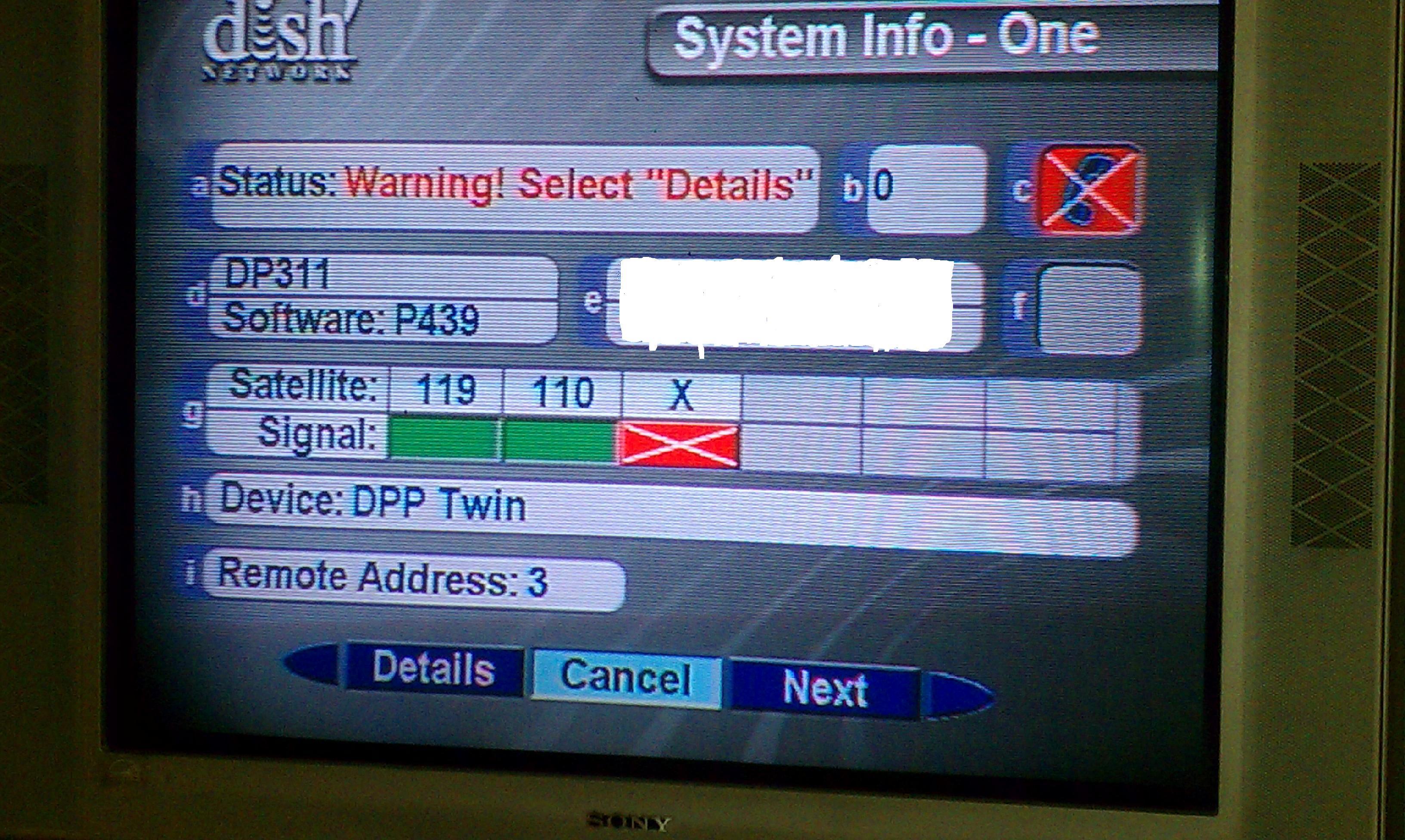

Finally, since she currently has only one RG-6 running into her home for her DP311 receiver (Dish 500/DPP Twin) I just want to verify that I can install a diplexor inside the home and run it to Satellite In 1 and 2 on the 622? If not, I'll run two fresh coax from the DPP Twin to the 622, and replace the old RG-59 from her OTA antenna...however, the existing cables work fine (excellent signal levels) and I don't feel like working on the roof in 95 degree heat.
Thanks!
If the LNB is TRULY a DishProPlus for 110/119 (or a new Dish 1000.2 dish) then yes all you need to do is plug the separator in and hook to both inputs
If its anything else you would need two lines
most HD on Western Arc is on 129
Hmmm. I viewed on "The List" and it looked like there was a lot of HD on 110/119, with all the HD locals on 129 and duplicates HD channels that were also on 110/119. I'm not sure how up-to-date the list may be. Regardless, I'm going with 110/119 and it should be fine since 70% of the stuff she watches is local OTA.
Snapped a photo...says DPP Twin.
