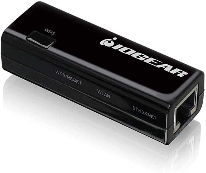

I think someone mentioned awhile back about some kind of powered Wi-Fi adapter that also has an adapter to plug it into the ethernet port. So, something like that may work. I have never tried it myself, though. As far as the ones that plug into the USB port, yes those have to be the actual Dish models.
When I had my condo in Florida, there was no cable run to where I had my receiver. I ordered one of these from Amazon and it worked just fine.
IOGear Wifi Adapter

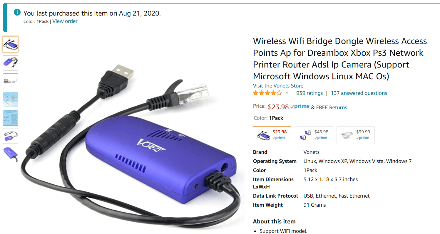

That was me! The OTA tuner and hard drive are taking up the 2 USB ports, so this made the most sense. It's been working great for 6 months.
