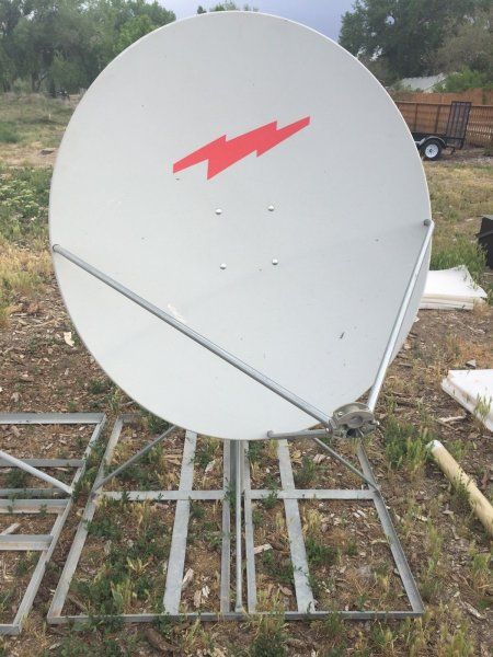

Saw this recently. Andrew Corporation 1.2 m used satellite dish. Seller is offering it complete with non-penetrating mount. $150. Is that a good price?
in my opinion, yes, at least if it's local. If you have to pay extra for shipping, that might be a different story
It's in Colorado; I'll be out there for the holiday next week. Not sure if it will fit in my car, though
As long as it looks straight. I worry about dishes that have bumps and bruises as they may have fundamental problems with their geometry due to damage -- whether by accident or carelessness.

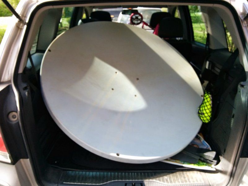

This Andrew (I bet that on the back of it you will find "Channel Master" stamp) is one of the best antennas possible to get on the market. Even if it is used, after washing it will not only look like new but also work like new. I had no problems fitting such a dish inside my car IMG_20150422_161210 (Large).jpg , but if car is not big enough than, as it is already mentioned, strapping on the roof is proper way to go. C-band on this dish is possible, but special LNB-holder must be used.
