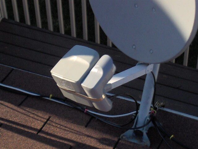

yes it will work. I did one a while back of 110/119/129 for Dish and it worked just fine.
(see picture below. Your other LNB would go on the opposite side of where i have mine

2nd LNB goes pretty much next to the LNB for 95. It goes on the right side (if you're facing the dish). It goes on the opposite side of what you think. The satellites go E to W but since there is a reflection off the dish, the 2nd lNB is on the opposite side :)
