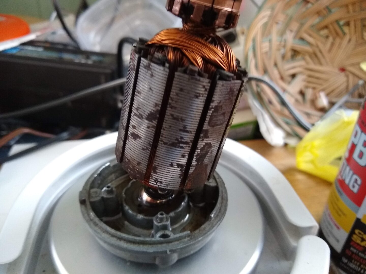

The motor on my Perfect-10 10 foot dishes 24" Venture actuator is damaged after storage. Looks like some water may have got inside, and froze. I'm rehabbing the dish and mount etc, to replace the 7.5ft SAMI dish I'm using right now. One of the magnets broke away from the wall inside, it's seized up, and I don't think it can otherwise be safely repaired. Anybody got a usable one I can have? Not sure what model this is, IF there's different motor models. I'd say this is at least 20+ years old. I'm including some photos, maybe others that have actually had to work or rebuild these motors have some input as to which one it is, and maybe have a replacement? Please let me know, thanks!
If you also need additional photos of something to better identify the motor, let me know.

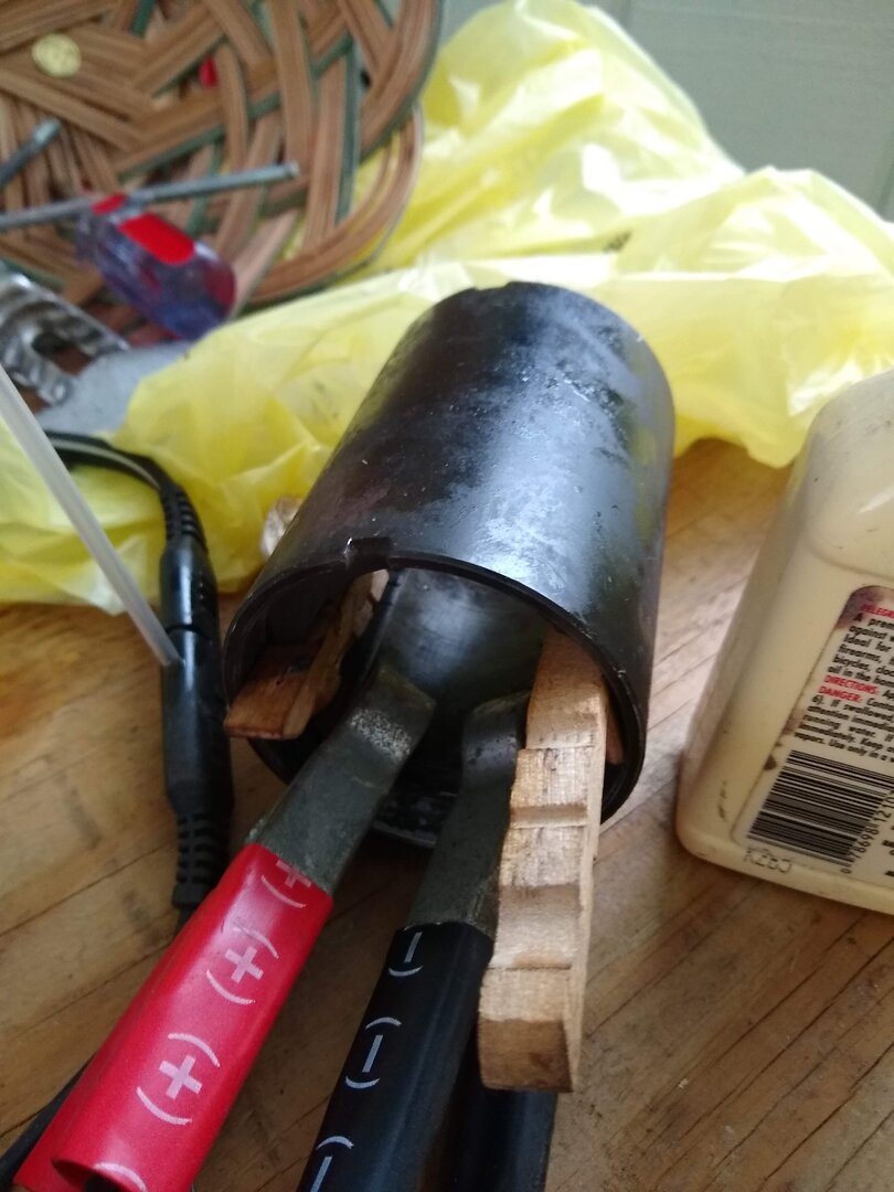

If you can possibly salvage it and the windings arent borked, commutator is still good. Bronze bushings aren't egg shaped and worn. Cool!
As for bonding the magnets I think the only stuff I found is 2 part urethane automotive body panel bonding adhesive. The stuff that Camaros are stuck together with.
Epoxy, JB has failed for me. I live in carbon brush manufacturing territory and if you're good at snapping good macro's and have a little bit of micrometer or caliper skills I could probably hook you up.
I might even have some old parts in my junk bin.

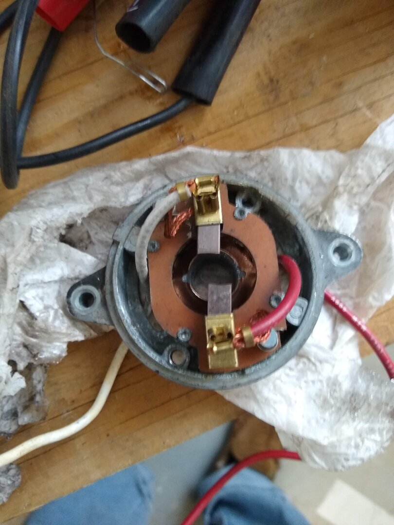

The motor brushes are fine, in fact they look barely used. I've never used a micrometer or caliper, sorry. I think if I could re-bond the magnet, and get the motor rotor loosened up from the end bushing, it might work again.

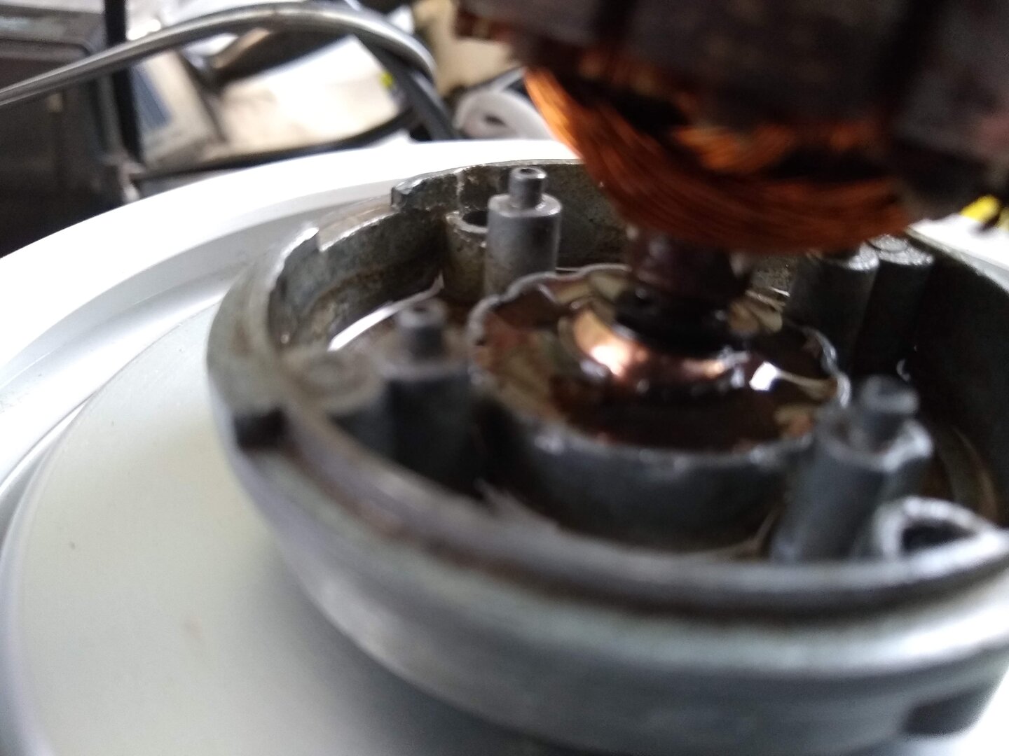

Is the rotor supposed to come OUT of the end bearing? Or does the whole thing spin with the rotor? Because that bearing appears to be brass, and is "gimble-like". Meaning the whole thing is kind of like a ball, and if you try to turn the rotor, the whole captured ball part moves, but is very tight. I don't seem able to pull the rotor out of it. Almost seems like it's locked in somehow with a C clip?
You're right. The bearing is supposed to gimbal in its fitting and the armature spins inside of the bearing just like the brush end. It has obviously siezed and just needs some soaking in penetrating oil. It's like it is now because it's been like that for a long time. Oil, light taps on the end shaft to work it in. Patience. Walk away and eventually it will break free. You could also try gentle heat on the protruding shaft with a Bic. Not too much though.
Reactions: primestar31
I would epoxy the loose magnet back in place. Also make a couple wooden sticks for spacers to slide between the magnets and hold them apart. Glue those in place. Free up that bushing like arlo indicated and you should be good for another twenty years ;)

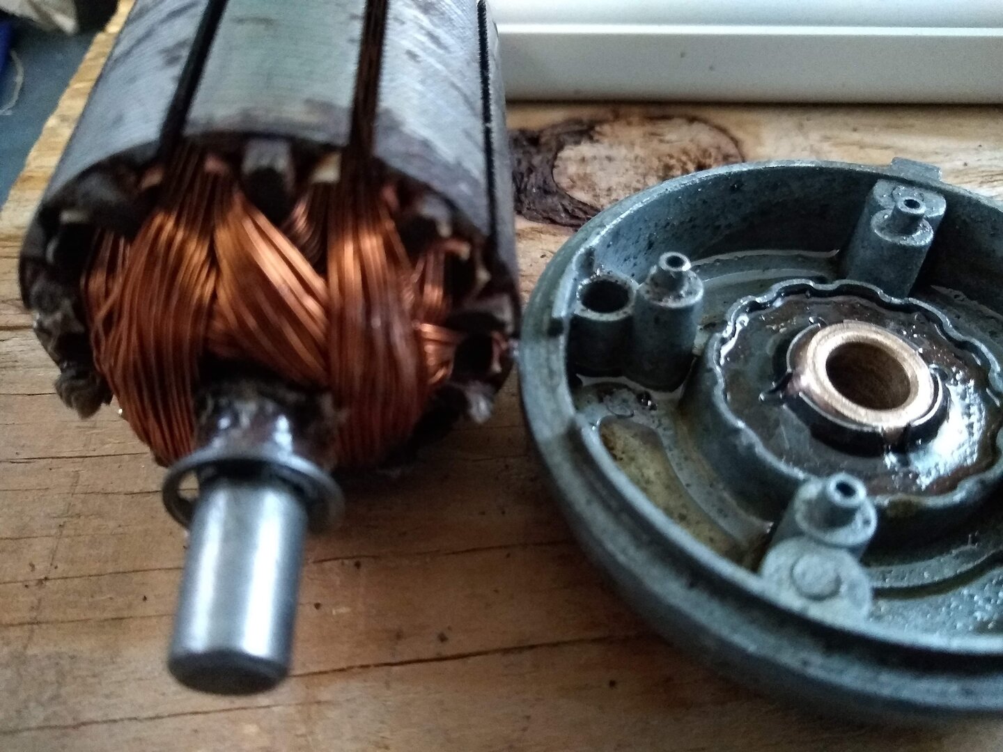

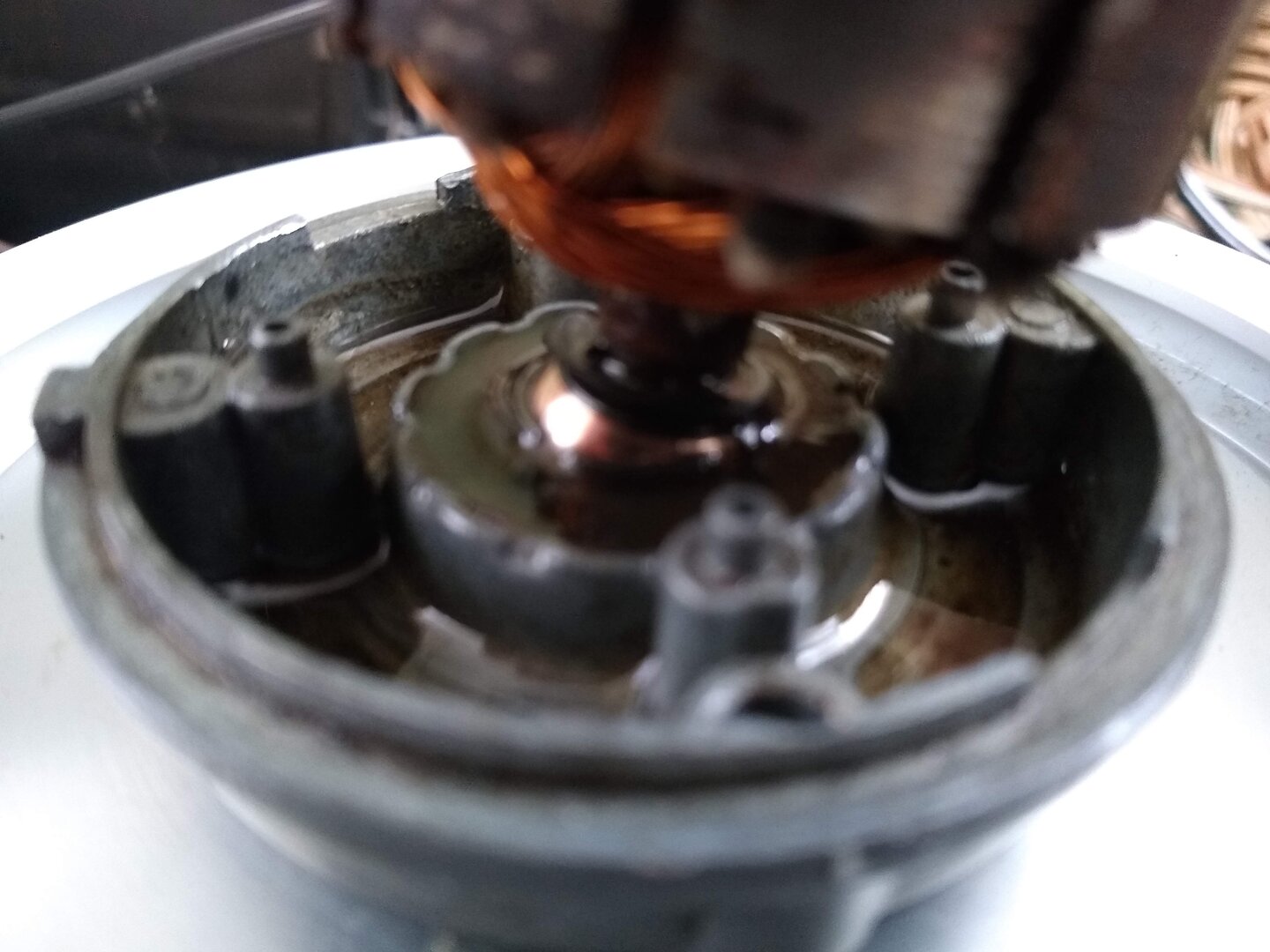

arlo Just how "loosely" should that rotor be able to turn in that end piece gimbal bearing? I have it cleaned at the point where I believe I've got most, if not all "gunk" out of it. I can turn the rotor by hand now while holding the end piece, and trying to spin the rotor with my other hand. So it's not completely seized up tight anymore. However, it doesn't spin REAL freely like say an induction type fan motor does. There's still friction there. Then again, that's all freed just from soaking the bearing in bicycle chain chain cleaner, and scraping a little around it with a sharp wooden stick. It's not been soaked in oil just yet.
Is it supposed to turn freely enough, that IF you gave it a little spin, it should coast a little by itself?
Were you able to pull the armature shaft completely out of the bearing to clean it?
It should spin closely to how the bearings in an induction fan does. Is the armature shaft really clean too? No sandpaper on it unless you have 1500 grit or finer. A Scotchbrite pad works.
Are you able to examine the bearing with a magnifier to make sure there's not an old grease or oil varnish coating on it? The bore of it should look "brassy" with tiny carbon pits or just like a piece of bronze. And a Scotchbrite texture on the shaft will help retain oil better than a mirror polish.

That bearing shouldn't spin in the bore of it's housing at all. That would be a bad thing.

arlo I didn't see your edit until just now, those don't re-notify via email
I've been talking about the brass gimbal bearing on the END of the motor, opposite from the brushes. It's completely captured, and I can't pull it out without likely damaging it.

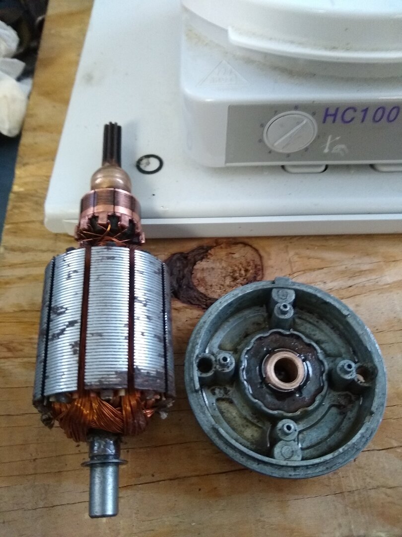

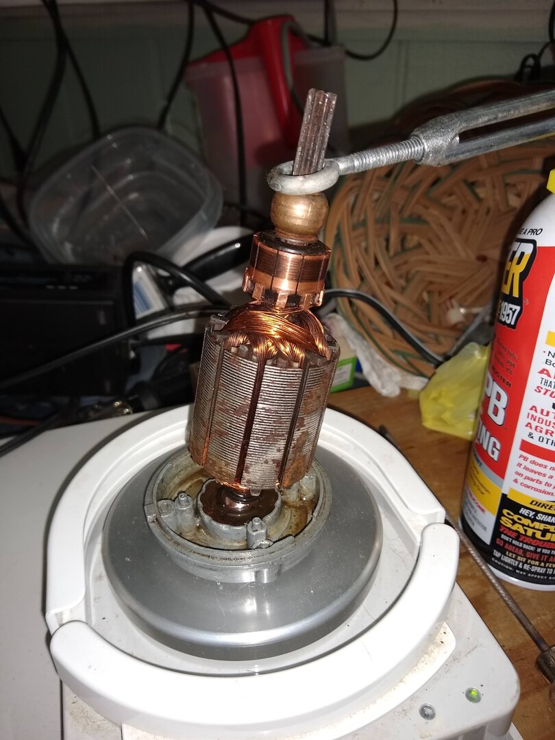

The belt pulley is off, it came off pretty easy. Here's some additional photos. Not sure how I'll get it all back together, and also get the brushes on the rotor. Hopefully that won't be hard. I have also cleaned and re-epoxied the magnet into position, waiting for it to dry/harden over 24 hours minimum. The rotor now spins much easier in that end bearing, though it still isn't loose enough to actually coast when you try to spin it, I don't think it ever was, but I have no real reference to prove that. I'm still letting it soak in oil, and I have it sitting on an old C-pap humidifier heater to lightly heat it up.

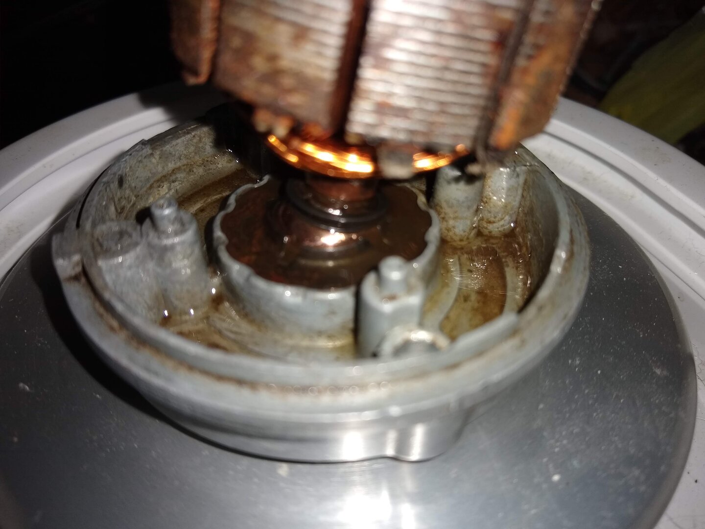

See that bit of rust 'staining' on the armature laminations? Should I also try to clean that off with a Scotchbrite pad?
I tore two motors down last night. Just for giggles and a little crud under my finger nails. Funny. I have a box of mechanics gloves 2 feet away!
Anyway both gear housings had pressed in sleeve bearings and gimbal bearings in the brush ends.
Your front bearing has to come off. Maybe nudge it back as far as you can towards the armature and see if you can't lightly sand the gook off that's keeping it from coming out. It went on. It has to come off.
Me....I'd want it off the shaft so I could clean out the old lube from the bore.
Yeah getting the rust off would be a great thing to do. Just be careful of the windings. Tape them up if you need to. Shine the commutator with Scotchbrite too. Don't take off much copper. Just burnish it nicely. If it's undercut (between the copper contacts) get the crud out from between them too. Brush carbon tends to short when accumulated between the contacts.
The motor will draw less amps and spin faster.
My suggestion too would be to take the front bearing and put it in the gear housing bore it goes into and check for wobble and slop. If it is worn perhaps right before putting it back together put some hot glue or even some silicone sealant carefully in the cleaned bore so it can keep the bearing from spinning in the bore. That wouldn't be cool if it did.
The motor looks in great shape and I've refurbed ones much nastier and they work like new. If the end gaskets are damaged.....silicone sealant to the rescue. Keep any moisture out of it.

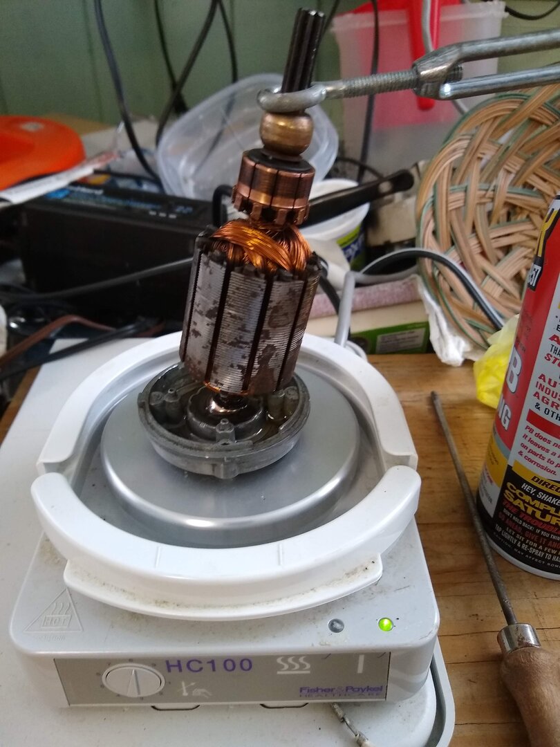

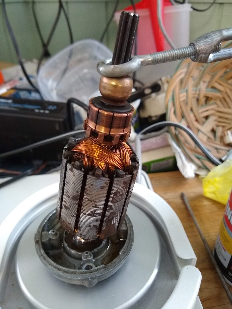

SUCCESS on the end bearing anyway!! I went down and gave it yet another shot of PB Blaster, and tapped the end with a hammer a few times. The rotor suddenly unstuck from the gimbal bearing. So now I can clean that up properly, and get the remaining gunk out of the gimbal. When it finally came loose, you could feel a bit of suction holding them together. Here all this time, I though the gimbal bearing ball had to come out.
Now, you say the FRONT BEARING ball has to come off that shaft also? You mean the one on the end where the belt pulley goes on, correct?
Also, what kind of lube do you use on the gear train? I was thinking about using some Lucas #2 Red N Tacky Grease
Hey, this is really starting to look like it may work! I soaked that end brass gimbal bearing with a little PB Blaster around top and bottom of it. I then used a deep-well socket over the rotor shaft, and sitting on top of that stuck bearing. I then tapped lightly a few times with a hammer on the socket. The bearing went down a hair. I was then able to grab a hold of it, and PULL it off the rotor! Now I just need to clean it all up and scrape out all the remaining hardened gunk, buff it and the rotor shaft a bit, clean the laminations, and get ready to put it all back together once the epoxy on the magnet is completely set!
arlo Thanks for your help, it's much appreciated!
Yes sir. The front bearing comes off the exact same way. Look for a little ridge of rust or crud that keeps it from slipping off of the shaft. It has to!

The brushes will be fun. Try a couple of bread ties around the copper braid to pull them back while you fenagle the commutator over them.
