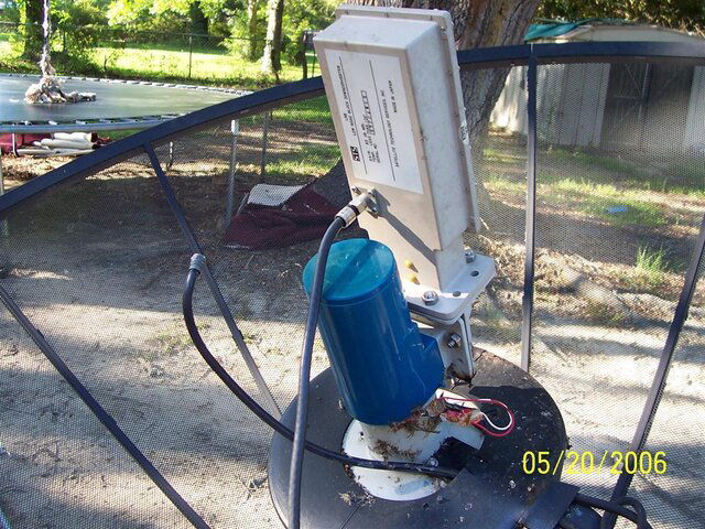

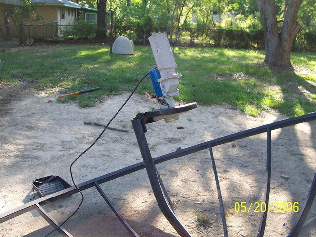

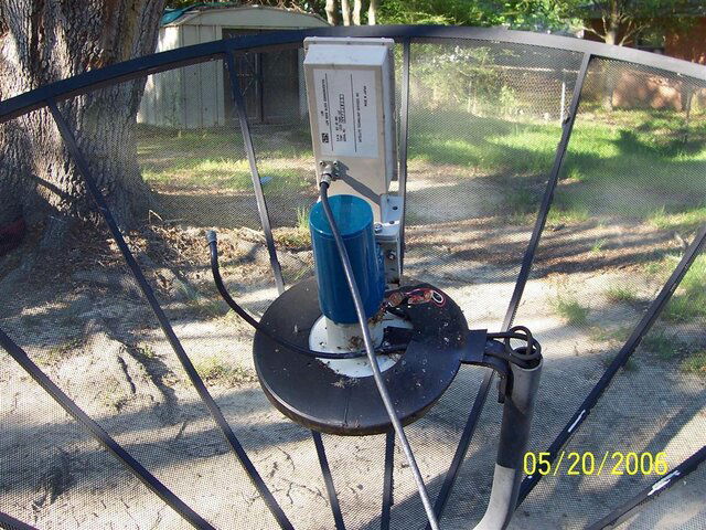

I picked up one of them today. I'm not sure how to measure this things but I measured from lip to lip without the tape measure falling in the "bowl" and it was 10.5 feet. The lnb is a STS with 63db gain and less than 100 degrees TEMP, sounds kind of old to me. Anyone have a recommendation of a C band LNB to use on a FTA receiver?
I hooked it up to a port on the diseqc switch mounted under the 90cm, I wasn't sure what to pick as an LNB on the Fortec Ultra. I did a blind scan a few times with the dish on the ground but didn't find anything. I thought I might get lucky but oh well... I'll wait till I get it up on the pole.

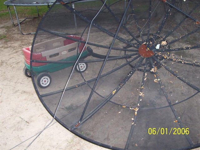

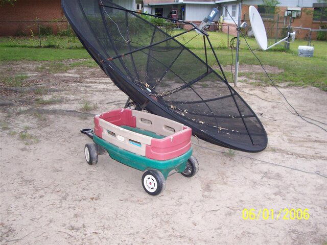

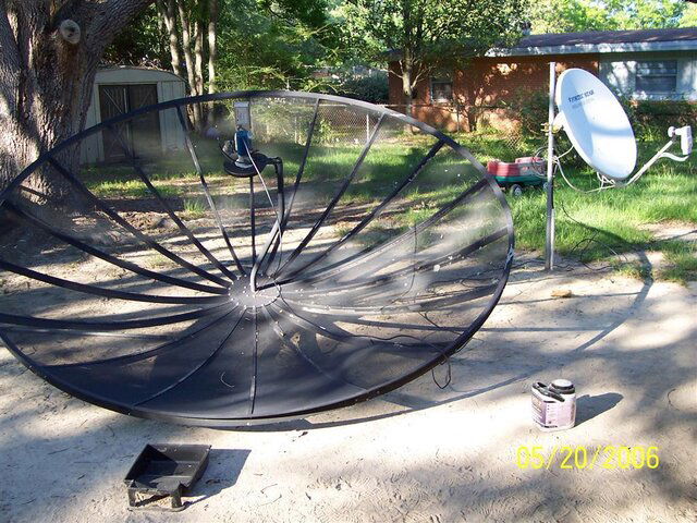

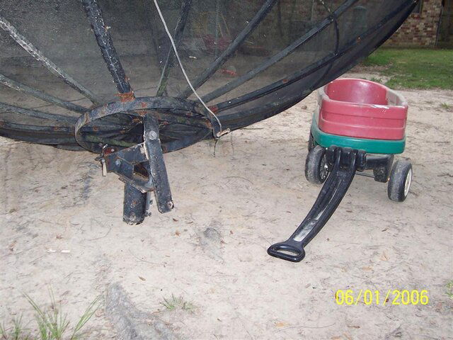

I picked up the second dish. A 10 footer. This one was much lighter than the other. The LNB was a lot newer (I think a 50 degree temp one) including the actuator. The analog receiver has no remote so I'm stuck working the transponders on the front. I brought the TV outside(in the dark of course), hooked up a piece of 18/3 for the servo and the RG-6. The dish is on the ground with no pole. I put it on TP 15 and started waving it around the sky. Within 10 minutes boom! I had video! AWESOME! It almost brought a tear to my eye! I found three analog TP's on G4! Awesome! I shoved the wagon under the side of the dish so it would hold for now. I looked through the back of the dish and I can see I'm shooting right through a tree. I hooked up the cable to the diseqc port, configured the fortec for cband and started scanning. It was awesome to see some DVB signals with 4 digits frequencies coming down the screen. I didn't see the nets but I'm not suprised due to my "ghetto" dish mount and the tree. I did find a few channels, including two HD ones and some 4:2:2 material but since we are not in the feeds area I won't mention them.
Time to get the tree trimmed back and this sucker in the ground!
Started comparing symbol rates to lyngsat and noticed I was on the wrong polarity. Switched polarities and boom..the nets on G4R popped up at 50% quality. I'm curious to see what I can really get out of this setup as I have no way of tuning the skew nor is the dish mounted correctly. It was neat to see WVGN on the screen again.

Digiblur, I'd love to see a pic of your C-band dish, propped up on a wagon, receiving the nets! :)

I couldn't find a signal at first so my last resort was to prop it up the pole like it was mounted in attempt to find the correct elevation. I propped it up and instantly saw a color flash on the screen. I then threw the wagon under it to hold it up. I picked up a Motorola Super 350i receiver with videocipher board....and REMOTE!! I was able to fine tune the skew this time and it looks like I'm able to get the nets at around 50% with this ghetto mount. I could probably get them better if I actually took the time to peak this thing but that's later when I get a pole sunk in the ground.
CONGRATS! 50 is pretty good for a Fortec. I think my 6 footer maxes out on 60 on those. The Pansat gets up to 75.
Those nets are awesome! Its cool to see the oddball VI commercial :)
Digiblur, thanks for the pics! Now you're a C-bander! One of these days I'll take the plunge... I've been eyeing several BUDs around here, all of which I'm sure are no longer in use and would probably be mine for the asking. Congrats on the new channels!
