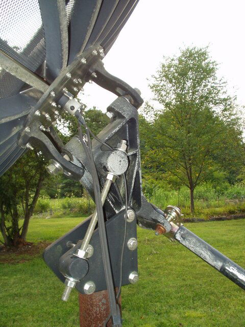

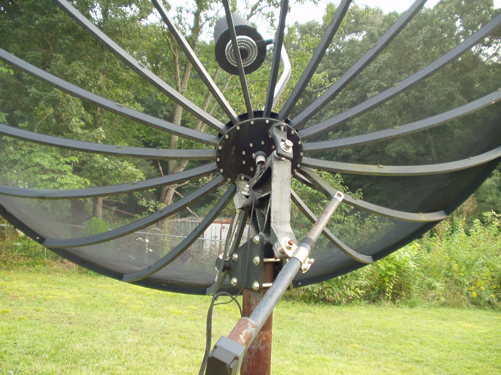

This one is within 2 miles from my house and I've been after it for about 2 years now. The people that own the property have finally decided they want it moved. Major problem for me though is my car trailer dish moving fixture is 3" pipe and this one is mounted on 4" pipe?
So can someone tell me what brand dish this is? The feed horn cover says Unimesh but it doesn't look anything like the one I already have.

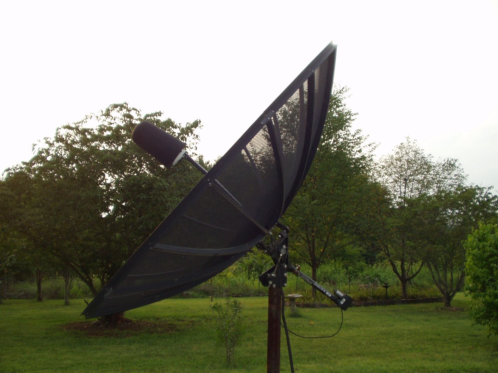

That thing is built like a tank! I don't know what it is, but there must be a tremendous strain on the center without a 2ft circular ring to cradle that dish. Must be why the polar mount is attached to a 4" pipe? Is it steel or alluminum?
It's an all aluminum 10 footer and they used SS hardware on it too so there's no rust anywhere except the dish mover. The polar mount is cast aluminum and pretty thick. The ribs going out from the center are solid aluminum and 1/2" thick so I doubt there's much flex in it. It looks good and is in much better condition than that 10ft Unimesh I'm currently using. The dish mover is a Super Jack so it can't be but so heavy.
Just got to see if I can find the pipe and stuff to make an adapter to mount it on my current 3" pipe. We'll see how heavy it is once we pick it off it's current mount. Once I get it off I'm going to cut the mounting post off at ground level so I'll have a piece of pipe to work with from that. I have a milling machine, a welder and some scrap metal here so I'm sure I can "rig" up something that will work once I get it home.
Maybe someone else will know what brand name this thing is. As heavy as it's built I'd say it was a "top of the line" dish back in the day.

As for your 3" pole, you can slide a 4" pole over it, and cross-drill holes top and bottom and use bolts to lock them together. I've done that, and it's like using a Schedule 80 instead of Schedule 40 pipe. Just make sure that the TOP of the 4" pole is slightly above the 3" poles top, and that it's flat and level. if not, you'll have a hell of a time getting the polar mount just right.

Thats a Raydx dish. Made in Florida. Thats why it has all stainless hardware. I scrapped one that a hurricane did a number on the mesh and bent some ribs from a pine tree that landed close enough to brush it.
Stogie5150 is right that is a Raydx dish, i pick one up about 15 yeas a go from a home owner that had one at hes garage roof. Holy smoke that is a heavy dish, i transported the dish back of pick up truck . Do no try to take the dish a part, it is structure like a 10" Orbitran dish with lots of ribs an mash sections.

10.5ft huh, ya know, when I was looking at the face of that thing it did strike me as being larger than a 10 footer but then again it didn't seem big enough to be a 12. I wasn't aware anyone made one that size.
I have one of those dishes completely disassembled in my garage and it is definitely a Raydx. It took hours to take down and strip and transport, thankfully the SS hardware made the job go smoothly with simple hand tools and no rust.
"Houston we have a problem!" Looking like the mesh on this dish is Cband only as the openings are larger than what the Winegard and Unimesh I have are? :( Search didn't find anything related to mesh size so does anyone know what the maximum mesh opening is that will still function with Ku?
