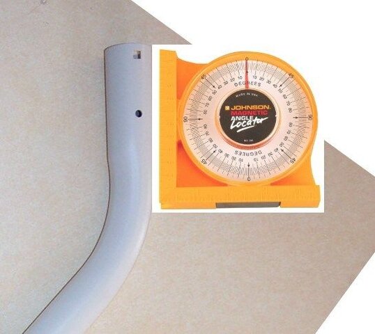

Here is a picture if that would clarify things :D
