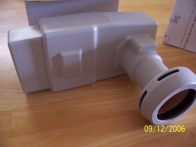

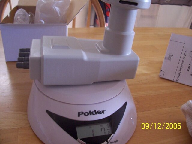

OH man, I must tell you, I love my Invacom QPH-031.. It's worth it and it's a bit heavy but still worth to have it! Here's pictures of my Invacom QPH-031 with weight!! :D

it did on my dish too. The holder wasn't strong enough to keep the LNB from being off a little (which hindered signal)
Gary Z said:
Don't think it would help... because the focal point of the LNB eye is lower then it is supposed to be.
That may be so. But, it is also causing the elevation of the beam to be off. (It actually may be pointing too high, if the tip of the arm is sagging.)
I will definitely be tweaking my elevation, if and when I get a QPH-031.
