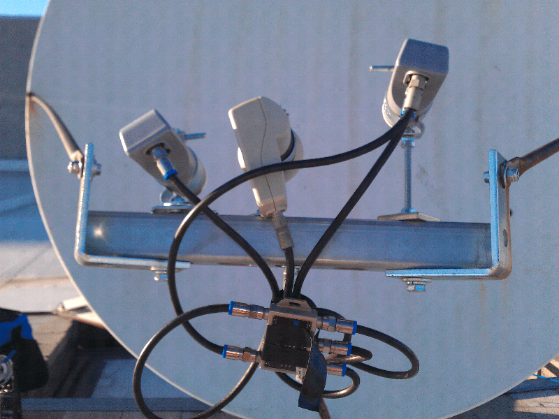

I will snap a better picture of my lnb mounts today. The arms on mine are intact, but the clamp was broken. I improvised, knowing I was going multiple feed with it.

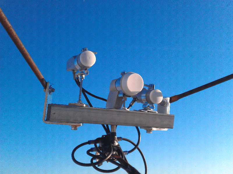

I am finally able to post the pics of my prodelin lnbf mounting method.
It is not a pretty install, but it works with parts I had on hand, unistrut, conduit clamps, threaded rod, and 1/4-20 hardware.
