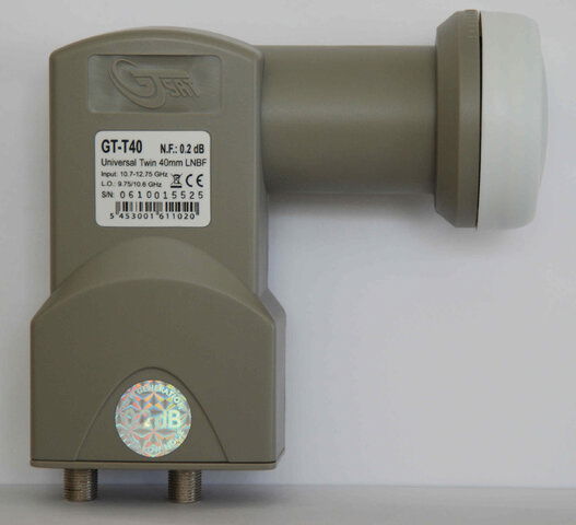

Just came accross also the very economically priced GT-SAT GT-T40 dual LNBF.
The specs are even looks better than the two previously mentioned!
(Low Noise figure 0.2 dB, and high gain 56...60db !)
Anybody has tried this out ?
Thanks!
what dish? what bird?
Well, unless you are on the hairy edge, they'll probably all work.
Most people throw away more signal in their garbage switches, than the difference between a top LNB and an average one.
And way too many think the cute Weingard 30 is the way to go, when tests show average 36" dishes outperform.
The guys with the 39-40" Primestar dishes are really in the catbird seat with all the extra square inches of collection area.
So, if you are thinking of getting a better LNB and a smaller dish, don't do it.
On the other hand, if you are in the far north of Canada, I'd guess the best most hearty LNB, and the biggest dish you could find, might make the best choice. ;)
Same is true for folks way south of the USA border.
Sometimes a 48-60" dish is called for down there.
Folks who live in the rainy south (Florida, maybe?) might want a bigger dish just to avoid the rain-fade problem.
I live in desert-like conditions, so rain is not a serious consideration.
For some hot birds, a tiny dish will even get the job done.
I live in Canada, about 4h north of the border. and my winegard 39" with invacom qph-031 works great for almost everything, but there are a few times the signal has been week even on clear days, and there are even more that I loose as soon as I get a slight rain.
bigger dish is allways better. quality lnb is important as well, buy a good lnb and an excellent sized dish.
I have two GT-SAT LNBs (different model number, GT-LST40C, standard, single output) which work fine. I also have Digiwaves, Ku Satellites, and Fortec Stars (universals, now "retired"). I have swapped and moved them (to get better fits against others, etc.) repeatedly. I really have never noticed any real difference in signal quality, except once (that I remember off-hand), and that was when I was using the Fortec Star universals and moved one of the standards and replaced it with the Fortec Star and saw a slight signal gain (probably about five percent). However, that could have been due to many factors other than the LNB (examples: fit better in the holder, slight change in focal distance, slight weight difference, slight twist of the holder when swapping LNBs, etc.).
