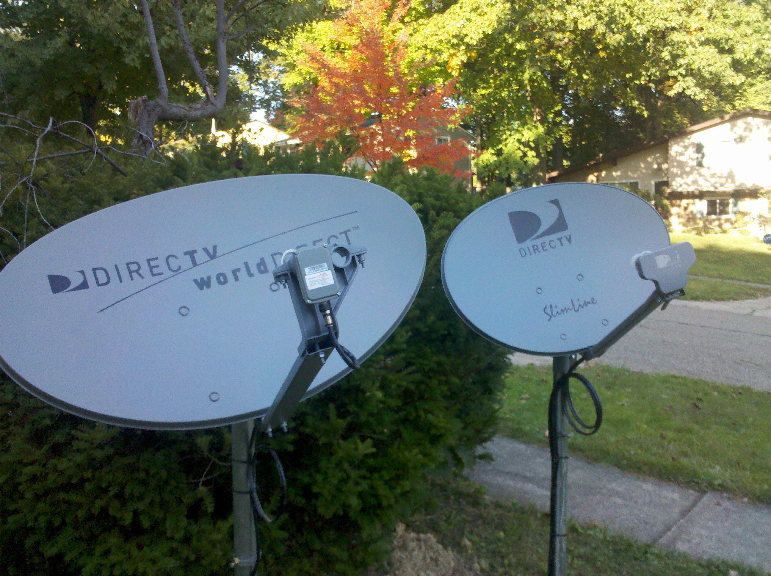

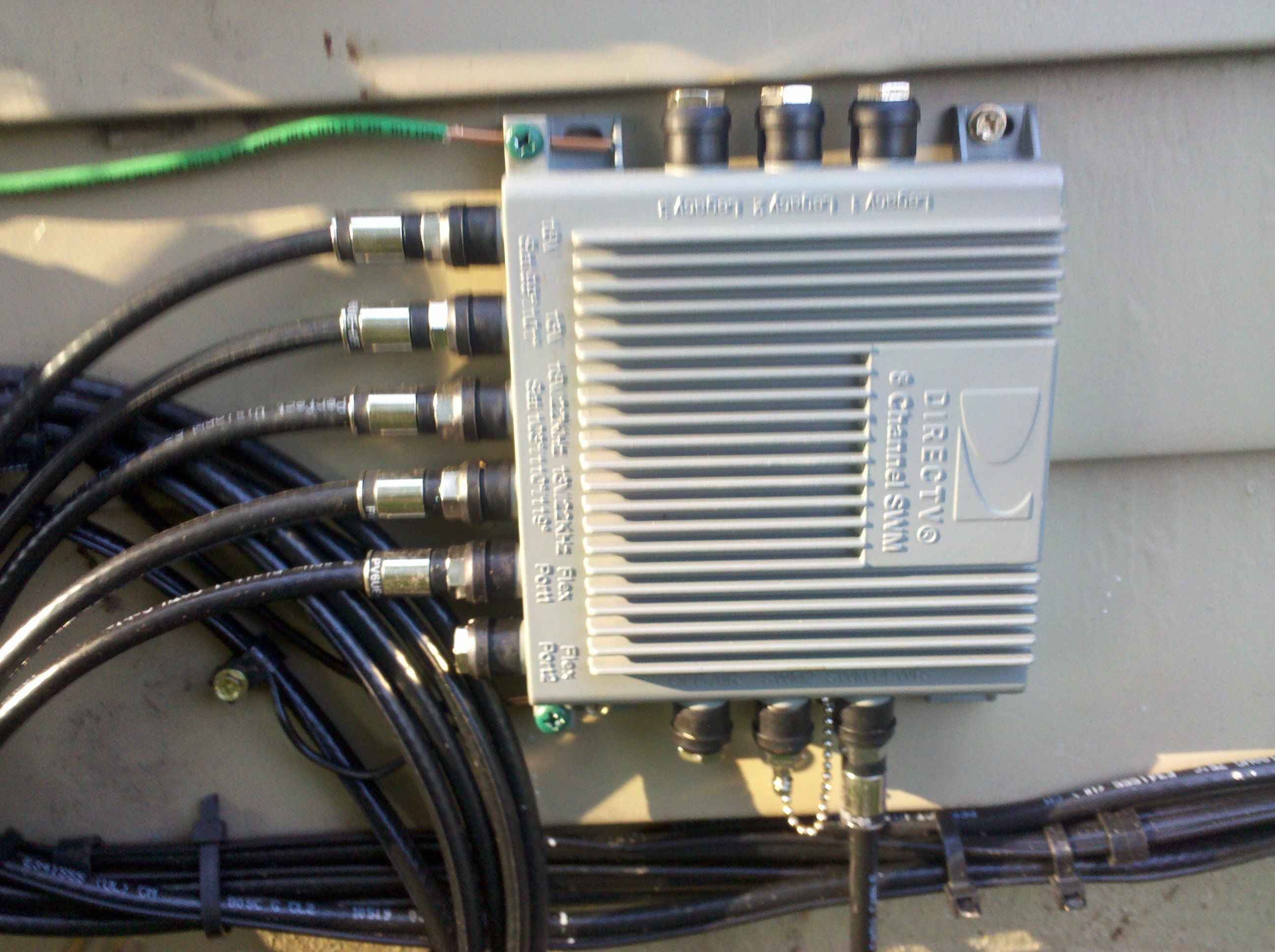

This is the setup i have:
I have two receivers.
Upstairs is a HR21-700
down stairs is a HR24-500
I have whole home dvr service turn on
<img src="http://www.satelliteguys.us/attachment.php?attachmentid=83558"/><img src="http://www.satelliteguys.us/attachment.php?attachmentid=83559"/>
You have exactly what you need for MRV to work. SWM8 since you're using the 95 dish as well so you've got a SWM system already. I'd call back and ask for retention. Sounds like the CSR didn't know you already had SWM for some reason unless they're charging you the 199 to flip the switch on your account. And yes, I've seen customers get the shaft and lose out on it because of the 199 charge.
I may be that in his account settings swim is not checked. Generally it gets done by oms when the order is processed that swm equipment is to be used and once the installer closes the ticket the swm check mark on the account gets placed. Problem is with out that checkmark OMS will think that he does not have it and charge more as it believes it needs to upgrade to swm.
