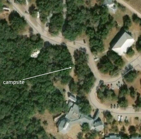

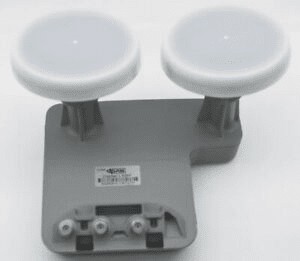

I was in a campsite that had a lot of tree obstruction. Moving my tripod mounted 1000.2 several times always had the 3 sats (110, 119, & 129) just barely clear of the offending branches. I was unable to get more than just a tone but no visible signal. I remain a bit foggy on what part of the antenna to point (azimuth). The arm or backplate (perpendicular to the line to the sats)? I was able to get the Diagnostics to indicate two different sats (129 & 110) by slight movement in azimuth. The skew and elevation were set correctly on a level tripod. The transponder numbers were different but I'll admit not having a clue what those meant. Using dual coax fed from #1 & 2 on the LNB or LBN?? See images on what to use as a pointer on the 1000.2. Really onclear on this part of the procedure (azimuth) to align. Used the Dish Pointer app and a compass to find sats. And yes, away from any metal interference. I would be interested in a meter recommendation but not some I've seen costing $400-$800.
Use the mount side plates as the azimuth aiming point, not the LNB arm. The only time the arm would be used is when the skew is 90 degrees.
"Mount side plates" ? Would those be the plates that are perpendicular to the back plate that squeeze the vertical support pillar?
Thank you Dutch. That should help. It has also helped to view the phone app (Dish Pointer Pro) while on my knees (same level as the center of the reflector) to make sure the "line" of birds does in reality clear the trees:confused:
Reactions: NYDutch
That photo sure looks like an EA lnb.
Nope. Western arc. When pointed correctly gives just over 50 signal strength on 110, 119, & 129 and great HD pix on both of the RV displays. I think my disturbing issue at Canyon of the Eagles was that the arc was always right at the edge of or obscured by tree branches.

Do you have an EA LNB on hand? It's not uncommon for me to switch arcs as we change parks and sites to use the clearest view.
Dutch, that's an interesting thought. From this campsite in central Texas there would have been no hope on seeing those birds.

I carry 200+ feet of cable (in 2 or 3 pieces) connected as required. With the pointer app, I walk around until either Arc sat, are visible. I have the dish pointer setup for both eastern and western Arc. Which ever Arc is best I change the lnb to that Arc. Setup tripod on that spot and level. Run the cable with an in-line signal strength meter and peak meter.
Looking at the picture there is an open area behind you site a little way through the trees. Should work.

You guys are great. I do carry extra coax in 25' coils but have never had to use it. The only other place I could have possible gotten a clean line to the birds was on asphalt in front of my truck or as you mentioned well back of the site. Problem there is it is an asphalt access road to the rear of the restaurant. I tried 3 separate locations that looks like they just may have a path. But no cigar. Just never any signal strength. I've also tested the coax all the way from the LNB to the Wally - both feeds (bedroom & living room). Each have two high quality barrel connectors. Wish I could afford a Something - Buddy but it is clearly overkill for the number of times we travel in the 5r. That is the tripod I use (TV4RV). One stout mother. And George has been very helpful several times. Thanks again for the answers.
