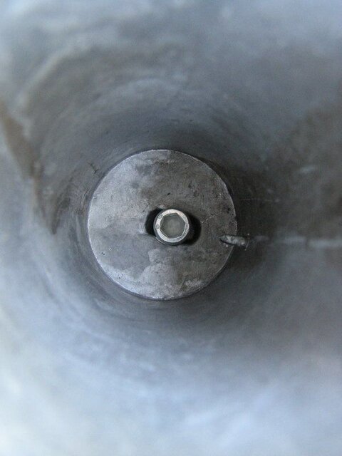

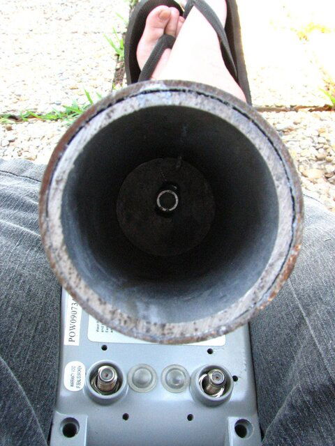

I did some more googling and I found someone mention something to the effect that the other model, the SG-9102B has a bolt up inside the motor tube that could become lose but that this motor, the SG-9120 does NOT have that bolt inside. Oh boy.....
So I went ahead the other day and took my motor totally down and looked inside the motor tube. HELLO! There IS a bolt in there. It's some sort of hex bolt, I can't remember what you call them. So I called Dad and told him about this and he asked it he could fix it himself. I said sure but he would be able to get the dish back to alignment without my meter since the whole entire dish had to be removed from the motor.
So he came and picked me up and we took it apart. He used some hex tool thing and sure enough, the bolt up inside it was loose! He tightened it up and then declared it to be "Tight as a tick". We put the dish back on then I sat down with my little meter and fine tuned the dish again. We go back inside and check and everything is working great!
Thus ends their wiggly dish problem.
I hope that this might be helpful to someone else with a similar problem.

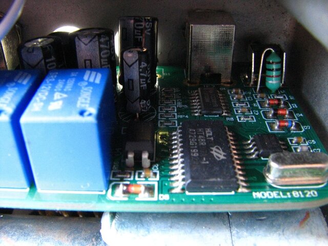

Also, while I had my motor down my dad wanted to see the inside of the gears to see the backlash thing. He couldn't see it, it seems to be hidden under other parts. But now that it's down and open, I took some photos of the inside. I'm hoping to one day find a way to add a power supply to the motor because my pc tuner card is too wimpy to move the motor and that annoys me, a lot!
Someone posted a few weeks ago about how to do it but it's not anything I know about and I'm afraid to mess with it without very specific step by step directions with lots of high res photos. It's going to be some time before that happens. If ever..
