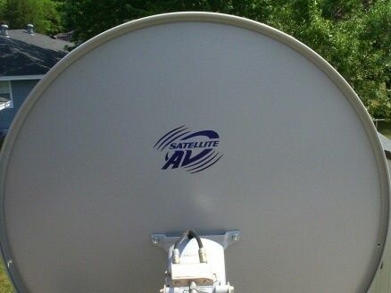

I also use a 36" SatelliteAV dish and have no problems at all with G10R, even in the rain ;)

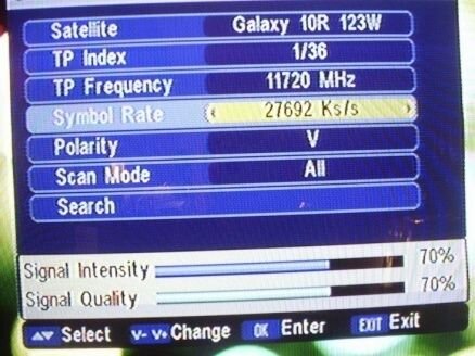

Signals are pretty low tonight at this end also ;) 70% Signal Quality (Usually around 74% signal quality)
36" SatelliteAV Dish and the Invacom QPH-031 LNBF and the Mighty Traxis DBS 3500 ROCK SOLID signal meter ( Reads a tad low compaired with all other receivers :) )
Rain is not a problem with my dish............
