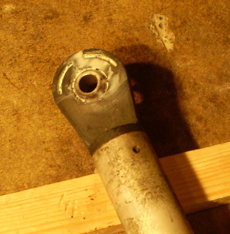

I did end up disassembling the JGS actuator and could easily clean and re-lubricate it, but the plastic/nylon eyelet on the end of the actuator looks suspect and I don't know where to get a new one. It has seized up - tried putting some grease and loosening it up, but it's still really stiff. If I could get a new eyelet/pivot I'd feel good about rebuilding the actuator it came with. I also couldn't find a replacement reed sensor that fits but I could make another work. The motor may actually still work, and could be replaced.

I'm not sure what exactly it's called, but it's the pivot joint at the end of the actuator arm that attaches to the polar mount. See pic attached.
That would be a heim joint. Some refer to them as a "rod end". Either way you're screwed because that's a proprietary part, ie, made specifically for this company. The heim joints that are used on a VonWeise mover are just standard heim joints that are threaded on the end and can be taken off pretty easily. The are also available from hundreds of dealers online and even on fleabay.
Having said that, if the rest of that mover works then I'd look at cutting that flat end off and trying to drill and tap it for a 1/2 x 20 heim joint instead. Don't know how thick that plug in the end is but if it's an inch or so, that's enough thread for a standard heim joint even if it's aluminum. You could take it to a local machine shop and have them drill and tap it on a lathe to make sure it's concentric with the shaft so a lock nut will fit flush.
FYI, My SuperJack mover has something similar and if/when that ever needs to be replaced, I'll have that one cut and threaded to make it work.

Lone Gunman: Yeah, the heim joint (thanks for the term!) plastic plug is hollow and seems to be very brittle.. When trying to "massage" it out of the end of the arm, pieces of it started to chip away pretty easily.
