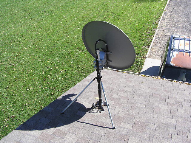

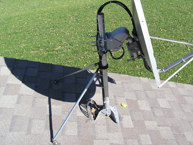

You can also try this arangement. The mast holding this 76cm dish is a 38 inch long piece of one and quarter inch EMT, you can get it in lengths up to 10 feet at Menards. I used the original mounting foot that came with the dish, drilled and squared holes in the EMT the same as the original curved pipe. This is very stable and would be difficult if not almost impossible to move the top of that pole off vertical no matter how hard you pull or push on it. The two struts attached to the roof are 1/2 inch electrical conduit roughly 22 inches in length. You can make the pole as tall as you want, just make the 1/2 diameter side struts longer. The collar that attaches the electrical conduit to the pole has a set screw to lock the collar to the pole, I welded two small flanges to the collar to allow attachment of the 1/2 inch electrical conduit. I also added an additional collar for the motor bracket to rest on.

I saw your other pics from your recent thread Walrus. I think your idea is a good one, very similar to what I was thinking of doing in the first place. After hearing of your success, I'll give it a go :)
Is that collar an off-the-shelf piece or is it a custom engineering job ? :)

I ordered the collars through Grainger or another company like that. I could not find the exact fit and the inside diameter was a few thousands of an inch to small. I chucked the collars in a latch and spend a few minutes enlarging them so that they slid nicely over the pole. I use cut pieces of angle iron for the strut to roof mounts. I first set the pole vertical and locked it down to the base place, then positioned the struts to form a 45 degree angle on the pole and secured to the roof. Lastly I slid the collar up or down on the pole until the mast was dead on bubble then tightened the set screw on the collar to secure it to the pole. I took my time initially attaching the struts to the roof so that it would not pull it off level side to side. Moving the collar positioning allows you to set the pole tilt forwards and back.
Once everything was tightened down I was surprized at how rigid this setup was, I placed a magnetic level near the top of the pole and tried to move it but couldn't. I wanted the bottom of the dish pan to have a lot of clearance from the roof to acomadate for snow drifting, that is why I went with the straight pole insted of the curved pipe.
Surely you weren't lucky enough to have studs at all of your mount points -- did you reinforce with material from the bottom side for your lags to screw into?
