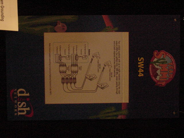

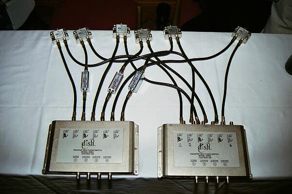

I'm trying to setup two legacy SW44's for a friend who uses large single dishes instead of DPP equipment. He wants to add a fifth receiver. Is there a diagram out there?
Very easy!
Get (4) high frequency (900-2050) MHZ 2 way power passing splitters.
Put it on each of the 4lines coming from the dish and run into each switch.
Make sure the splitter on port 1 is also used for port 1 on the other switch.
Do the same for port 2,3 and 4
The splitters can be all port power pass or single port power pass and either 40-2050 MHZ OR 900-2050 MHz.
you can get them cheap online or I believe HOME DEPOT has the right splitters in their electrical dept

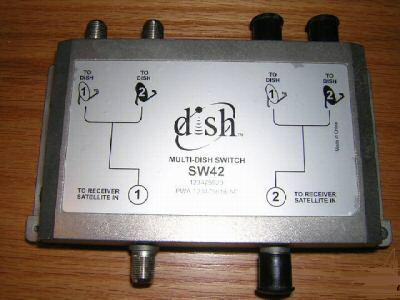

You're right, I've been out of the business too long. Remember this?
Reactions: charlesrshell
Yeah, but is was basically (2) Sw21's
But the neat thing was you could cascade a SW21 with an SW42 and see all 3 sats
There used to be a knock off switch by micro royal called a sw21x which was basically 1/2 an sw42 for cascading purposes.
